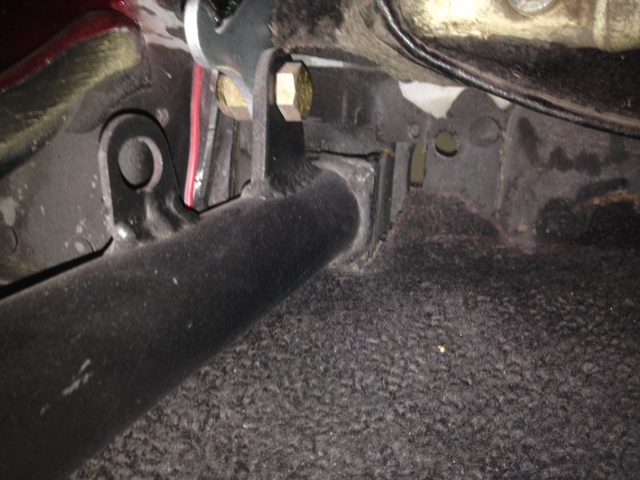

Old 03-10-2014, 08:32 PM   #7
vetteboy
Join Date: Mar 2011
Location: West Olive, MI
Posts: 35
Likes: 7
Liked 2 Times in 2 Posts
Default Re: Mid year corvette cage ?

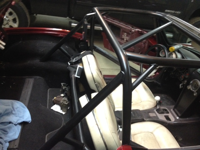

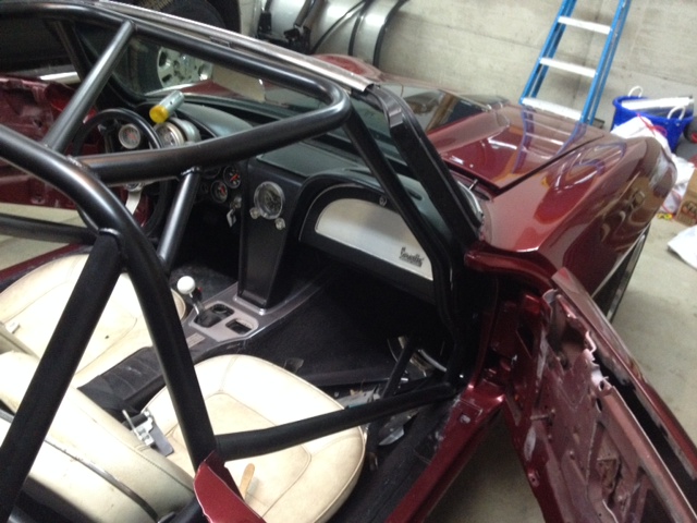

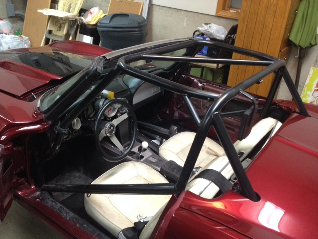

Here are a couple of pictures of my car. I just got the car back from being painted. I didn't have to modify any interior parts other than the deck lid. The hard top fits but tight. If you are a tall or bigger guy put a swing out bar in it.
ID:	23044   Click image for larger version
ID:	23045   Click image for larger version

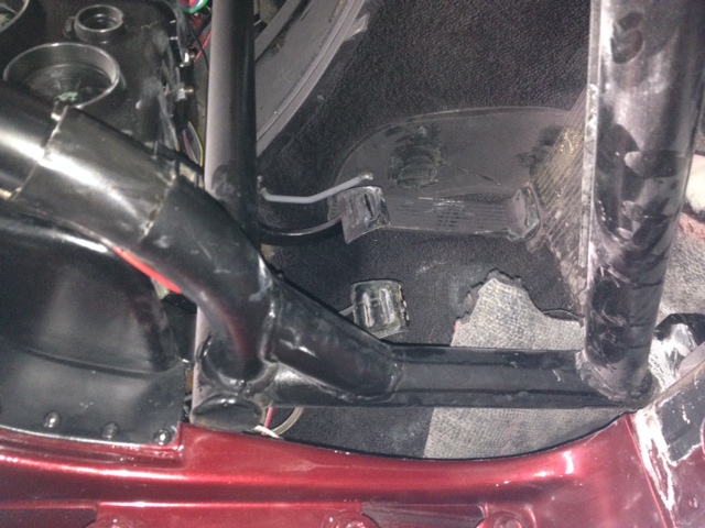

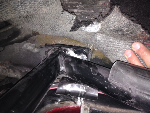

Glad you posted. You sent me a couple of pictures of you vette before it was painted but I couldnt remember what site you were on. What did you weld the main hoop too. It looked like it went into the corner of the chassis where that triangle brace is from the side rail to the rear crossmember is. I like the fit of our cage. Its pretty much what Im looking for. If you have a few more picture please send them. What size hoosier slick are you running. I Have a 28x11.5 et street on mine now to see the fitment. Its on a 7" centerline with a 4 7/8 back space. It just about fits from chassis to quarter panel.
L79racer is offline   Reply With Quote
Old 03-10-2014, 11:07 PM   #9
vetteboy
Join Date: Mar 2011
Posts: 35
Likes: 7

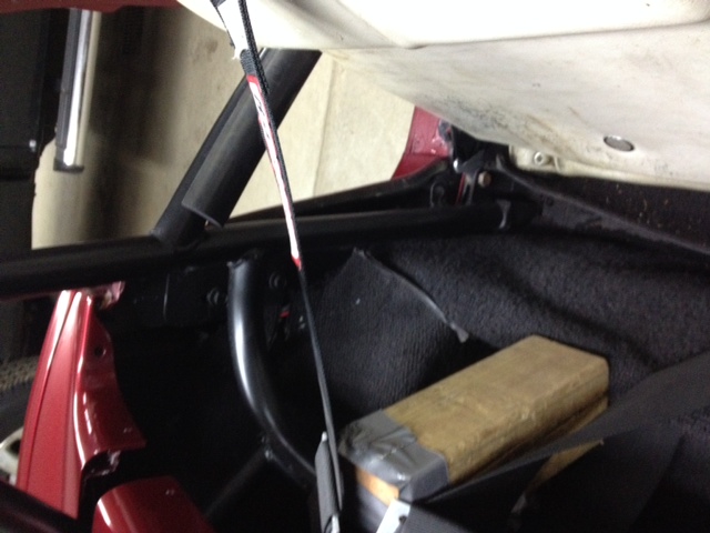

The car was in black primer when I sent you those pictures. The car looks awesome now. I run 29.5 x 9 M/T slick on a M/T wheel 4.5 back spacing. I made my own perch/pads off the frame so that the cage could be welded on a flat surface. I had the guy doing my cage tell me where he want to connect to the frame and then I took the body off the frame and made my perches/pads. If you need any more pictures or have any more question send me a PM. Brett
