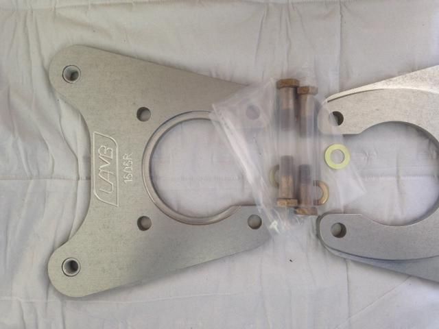

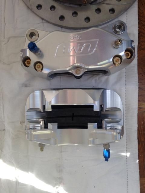

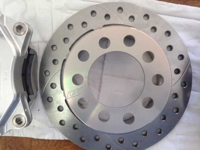

Well after much deliberation I went with these, Fed Ex dropped of the rears yesterday
