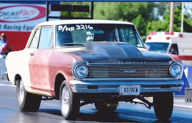

I've got a 65 ChevyII that I'm building for brackets. I'm currently running a 295/65-15 MT radial for the street/strip. The car is minitubbed, 8-point roll bar, 9" Moser rear with mono leafs and Cal Tracs. I have Calvert shocks in the rear and want to run a 9 x 30 Goodyear slick for better consistency bracket racing. What is a good compound to run, or is there only one for that size tire. Any other suggestions will be appreciated. The car is kind of set up as a Stocker. Dave
