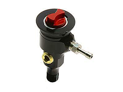

Not sure which A1000 you have, but if there's an 1/8"NPT gauge port on it, you can use the Aeromotive 15631 sample valve. I bought one and used it with my Magnafuel regulator...nice piece, plus it has another port for the gauge.
Attachment 18689
