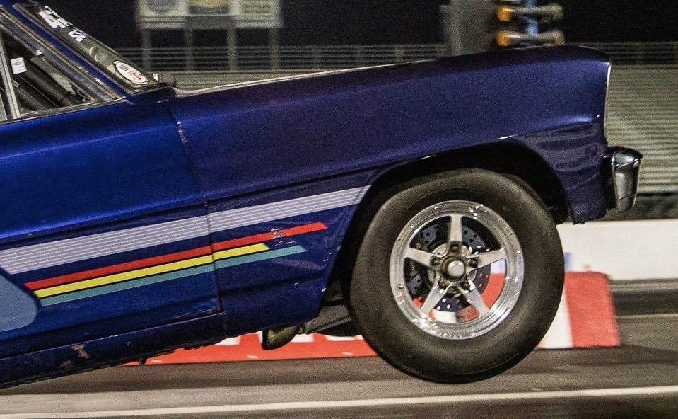

Originally Posted by KennyAnderson View Post
This is preposterous!!!! Didn't you read what 1320 said!?!?!?
Our car would only run fast like this. I’m not getting into any arguments with anyone. We tried it several times, it would not run fast tied down period. That’s a fact.

AGAIN, for those that don't understand how the timing system works and we know there are many here, just ask them how autostart works and for those that failed basic math...
if you get to the 60 foot clocks slower and you WILL, breaking the beam with any part of the car behind the front tires no mind the back tires, you WILL run a slower ET!

Wrong!
Explain these two runs
Run 1
1.349 60 foot Small wheelie
4.053 330 foot
6.390 660 foot
104.78 660 mph
Run 2
1.458 60 foot Big wheelie rear wheel 60'
4.049 330 foot
6.388 660 foot
104.49 660 mph
REAL world proof that A BIGGER WHEELIE DOES NOT SLOW YOU DOWN!!!!

Originally Posted by TOSTO RACING View Post
Wrong!
you're wrong and CLUELESS!
I believe NOTHING on read on the forums and half of what I see with my own eyes!
You can't defy physics nor how the timing system works!
Lol I ran the car last weekend you can go to world wide tech raceway app and find exactly what I typed car number is 5664 what don't you like about the FACTS LOL LOL

Malarkey not FACTS!
I KNOW that...
That statement is indisputable and FACT!

I don't go through the traps with rear wheels just the 60' lol
Okay you win
