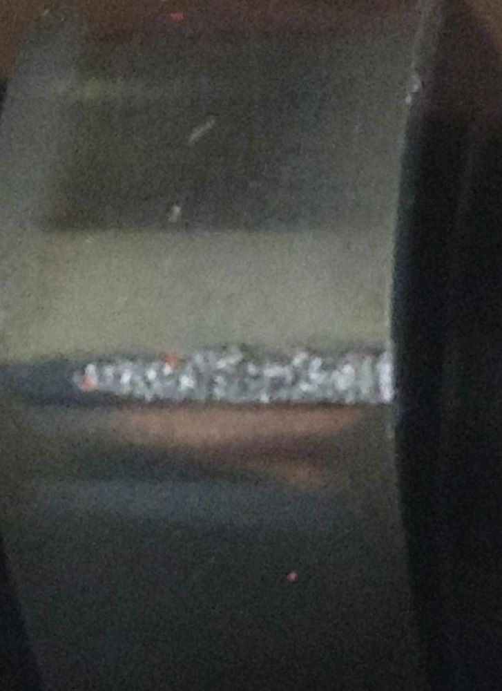

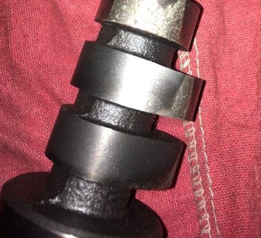

Originally Posted by nolongerracing View Post
I don't know what the answer is, but it's not a roller cam!!!
Looking at the photograph of damage to the cam lobe makes me ask one question. What brand/type of oil was used in this engine?
The reason why I ask is my new 350 engine had about 30 runs on it and began to run slower and slower. I checked the leak down and one hole had 40%. I sent the engine back to my engine builder. It was discovered that all 8 pistons were ruined, along with the tool steel lifters. I always used Joe Gibbs oil and never had any problems. Gibbs oil was sold and manufactured under the name of DRIVEN oil. Samples of the used oil were sent in for testing. The results have not been received yet. Has anyone had issues using DRIVEN oil?
John Duzac D/S 4448 STK
John Duzac is offline   Reply With Quote
Old 11-06-2022, 12:01 PM   #79
nolongerracing
Join Date: Oct 2006
Posts: 175
Liked 72 Times in 27 Posts
Default Re: Billet cams and lifter supply
This is a "steel" stocker cam that had Shubeck lifters. 240/500 spring pressure. VR1 oil most of the time. Gibbs or Driven when needed. May have 200 runs on it. 15 of the 16 lobes are like this. Notice it's in the same place on the lobe. Joe Shubeck told me this is from a poor core or poor heat treat. He said to treat the cam lobe as a new "highway". As soon as the first little imperfection is found and tires keep rolling over the same area you create a "chuck hole". Thats what we have here.

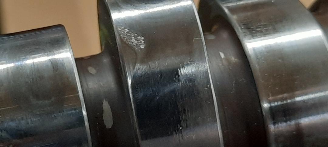

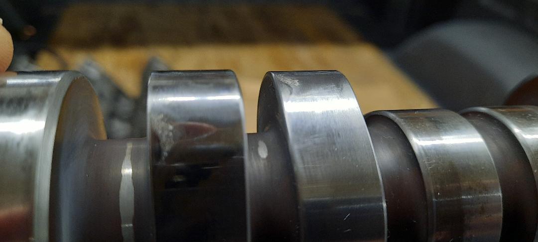

Nitride cast cam. 200/400 spring pressures. The most common issue. Tool steel or Shubeck lifters. Didn't matter. Oil, didn't matter. I was told by a cam salesman that if you got a year out of a cam like this you were "doing good". Thats why we switched to steel cams. The problem continues.
Going back to "pure stock" rules will not help. Just lost a few lobes in a stock rebuild 350 Chevy. We did everything we could for break in. Oil, additive, 1.2 rockers, 1/2 hour run time, etc, etc,. Cores are junk, lifters are junk, oil is junk, heat treat is junk.
Hate to say it.. Seems to start with the EPA!! We can't build what we need!!
