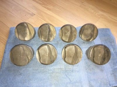

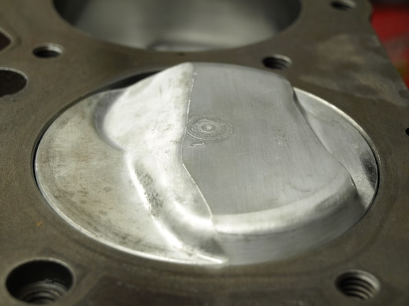

With the current camshafts in used, there is no way the valves will clear the piston dome. Many years ago, in the 1900's, a racer asked me to stop by his home to check why his new Crane Cams Stocker cam would not clear his pistons.
He believed he was doing something wrong. After checking the cam, the cam was not the problem; it was the piston domes. After making a few phone calls, I learned many were having their pistons flycut to be able to run the cams.
Having compared the current approved pistons versus the original, and they are very different. I assume someone may have sent a modified piston to NHRA to get approval of the alternate approved pistons.

Huh, that's weird, because a friend of mine used to run the approved TRW L2242F30 pistons with a Lunati stocker cam and no issues. This would have been back in the early to mid 1980's. They had unmodified top domes and his heads were the #840 castings IIRC.

In the mid 1980's they still checked duration and overlap. After changing the rules allowing any duration and overlap, everything changed. The lobes, duration and overlap changed.

Yepper.......That's how it happened !
