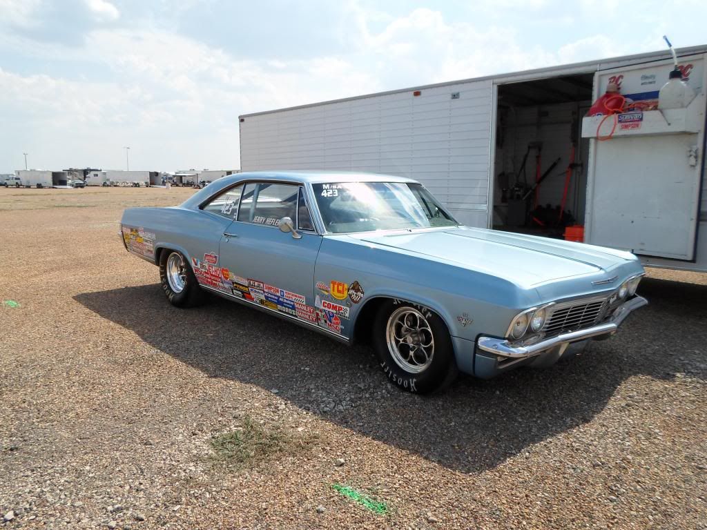

Unless I am mistaken,this was Dennis Oliver's M/S - P/S 4 speed car for a zillion years. No telling how many trips it has taken down a strip.
Was always a very nice, well detailed car.
