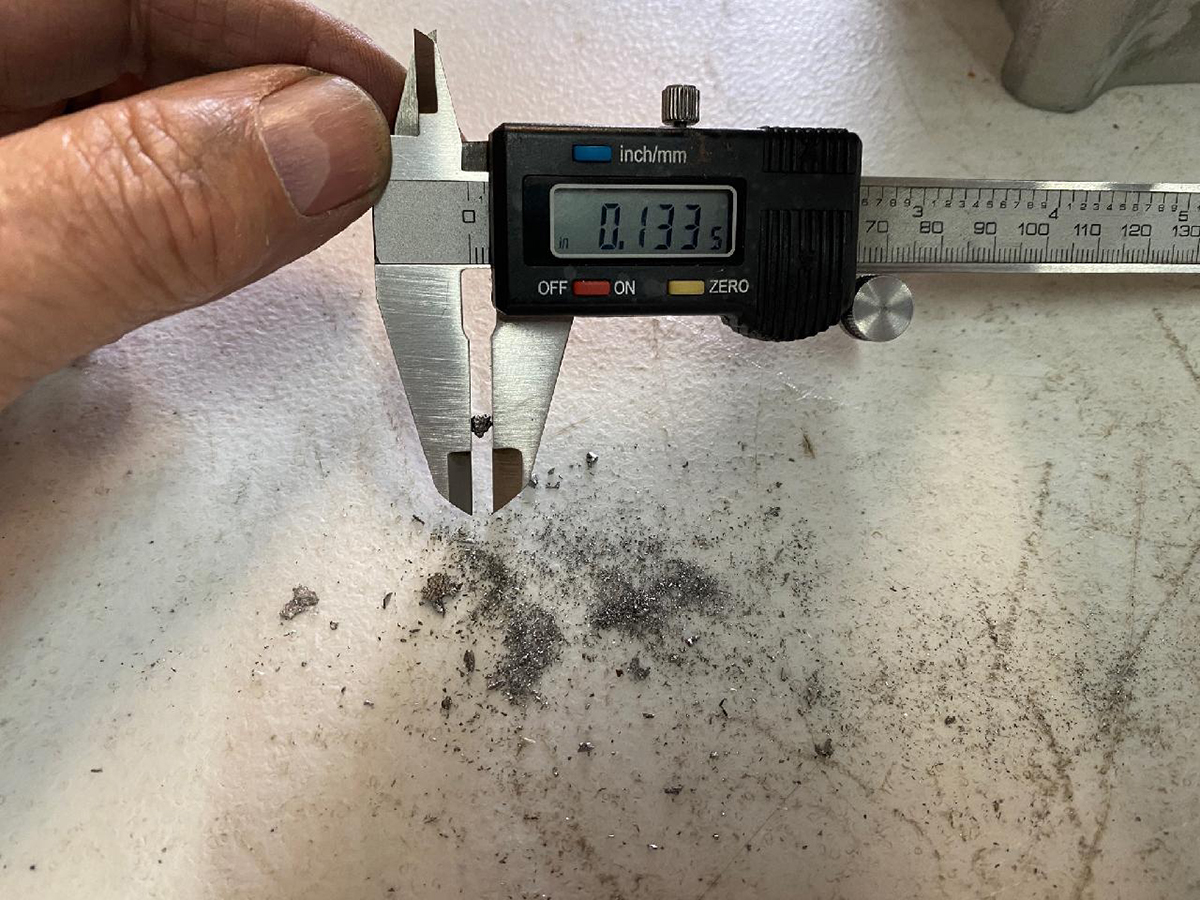

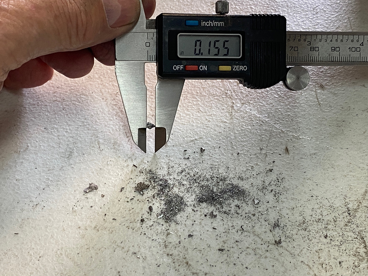

To all who build there own stuff, this is what I scraped out of my new manifold for my new engine. The casting sand and the "Dingell Berries" I was able to scrape out with a dowel. I think a stiff wire tooth brush will work to get the rest of the sand out.
So much for quality control.
That junk would have destroyed a set of piston, rings, cylinder walls, valves, and valve seats.

Old 02-22-2023, 08:10 PM   #769
tommy d
tommy d's Avatar
Join Date: Oct 2010
Location: Indiana
Posts: 830
Likes: 1,627
Liked 359 Times in 135 Posts
Default Re: Dumbo The Flying Elephant
Somebody's slacking. Not good.
