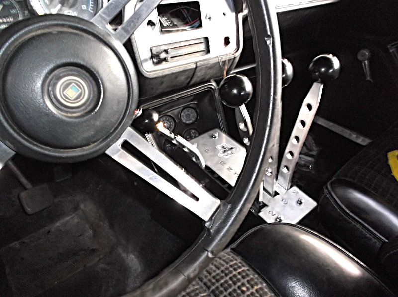

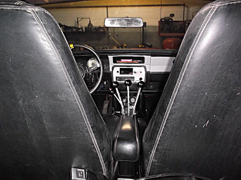

A little more gradual refinement has been going on, it's been slow going lately, but the auto shop has slowed down some since the weather improved. I've got my lift back now! Got to get underneath this thing and get some loose ends tied up.
Got the shifter installed in it's permanent spot now, the factory gauge cluster and console were interesting to fit into the scheme of all this, but after some carving here and there it all fits back together now. I had a ball playing with those shifter rods! Can't wait until it actually controls something that's running.

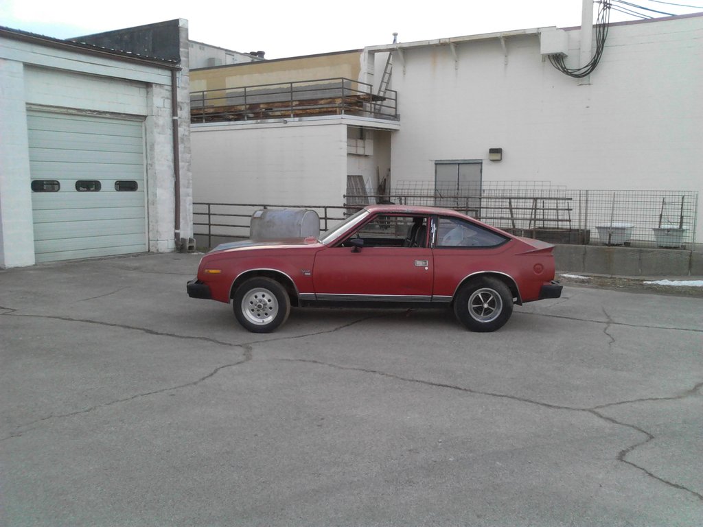

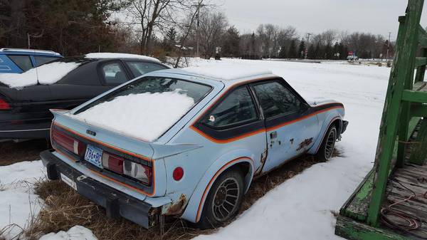

Just made a deal for a parts car that will offer up almost all the AMX goodies I needed to convert the Spirit over to a true T/SA '79 car now. Also got the wheels off my old race car installed onto the build car. Looking a little racier now. The difference in weight between the factory wheels/tires and the Welds/tires is astonishing! Had to have saved at least 50 lbs.

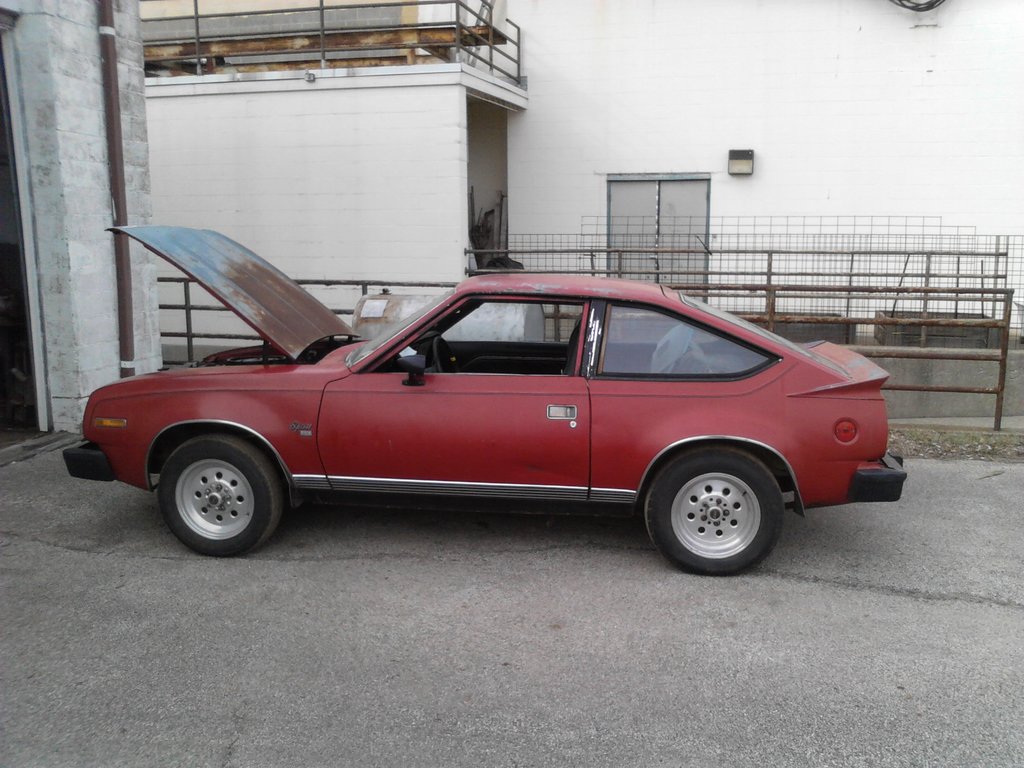

And the resized pics of before and after wheels...car sits up pretty good now!
You know, I'm always amazed at the little unseen differences from one engine family to another as these older cars came off the assembly line. I've already went through the crossmember differences on AMC engines previously in this thread, but today I realized while hooking some more things up in the engine bay that I had to change the whole gas pedal assembly because the accelerator cable was different from a 4 cyl to a 6. It was quicker to just change it ALL out as an assembly rather than mess with the cable itself.
Down to about 708 more things to do.
