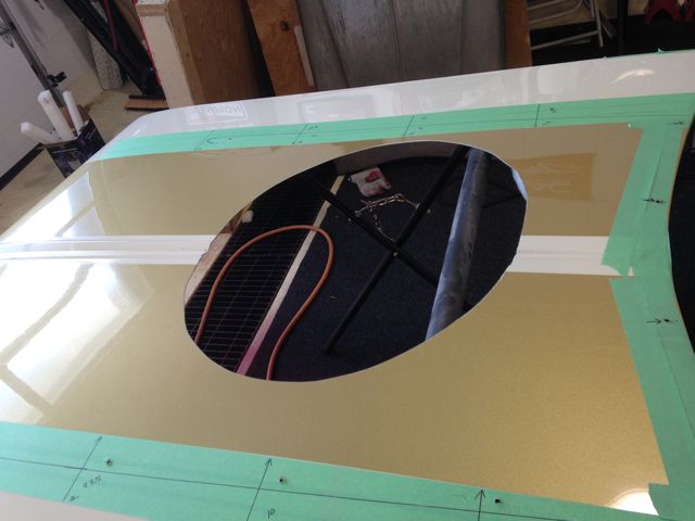

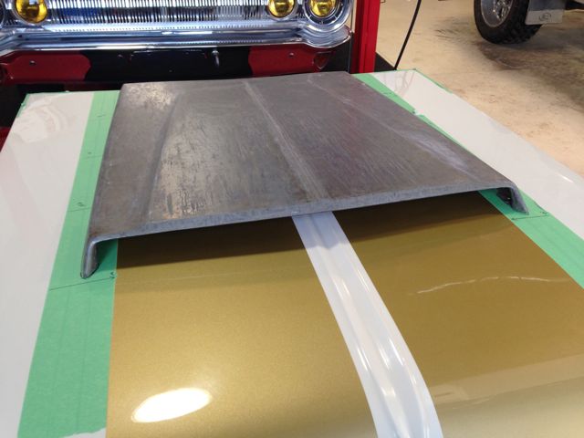

I cut the hole in the hood from a pattern I bought off the inter-web. I marked it out......looked at it for 4 days before I had the nerve to drill the first hole! I ordered a bolt/clip kit from Kramer's, so next step is to bolt it down to hood and send it all over to the body shop for finishing and paint.

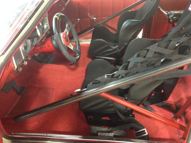

Carpet and interior are finished, shifter mount, weight box, and bolt on weights are at powder coating place. The easy part is done......Now I have to get started on a engine and trans. If anyone has or knows of anyone with a 426 hemi stocker motor/short block for sale please have them contact me?

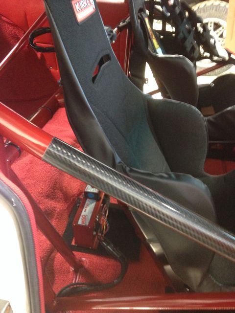

Tom,great looking car you are building as always. May I ask what you used for the side bar protectors? Are those the carbon fiber from Bickel or such or vinyl and are you satisfied? Thanks Gary

Gary, sorry it has taken so long to get back to you but I have been gone for a couple of weeks and missed your question. The carbon fiber bar protectors are from Bickle. I fit them with a cut off wheel and die grinder until I'm satisfied with the fit. Then I put masking tape on the bars for a guide, and to control any miss guided glue. I put contact cement on the bar and carbon fiber pieces let tack up for a couple of minutes then put them in place then tie wrap down for a day. Peel off the masking tape and remove the tie wraps and it looks great!
