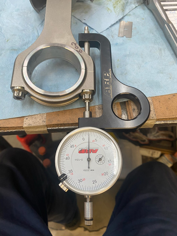

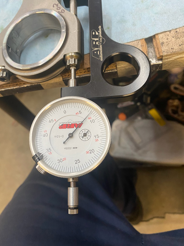

Checking for rod bolt stretch. .602 in the relaxed position. After .0055'' stretch to 6075''. After all the bolts I will check big end of rod. I think size is min. to max ID is only .0005.
