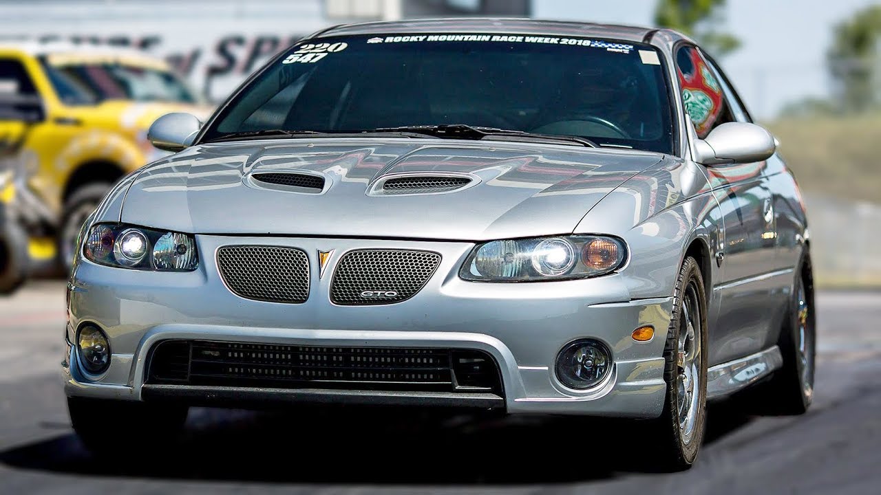

"... A more interesting choice would be a modern GTO with traditional Pontiac power. Good aero...and donor cars are out there."
Now there's an Idea I hadn't thought of. Anybody seen or heard of a Pontiac powered GT car, using a late model GTO body ?
I like it !
I like it !
No, and the wheelbase is quite long, by comparison.

From a quick Google search, looks like it's shorter than the earlier GTO's, but longer than Birds.
So, is that a bad thing ?
I mean, is it a "shorter is better" deal ?
