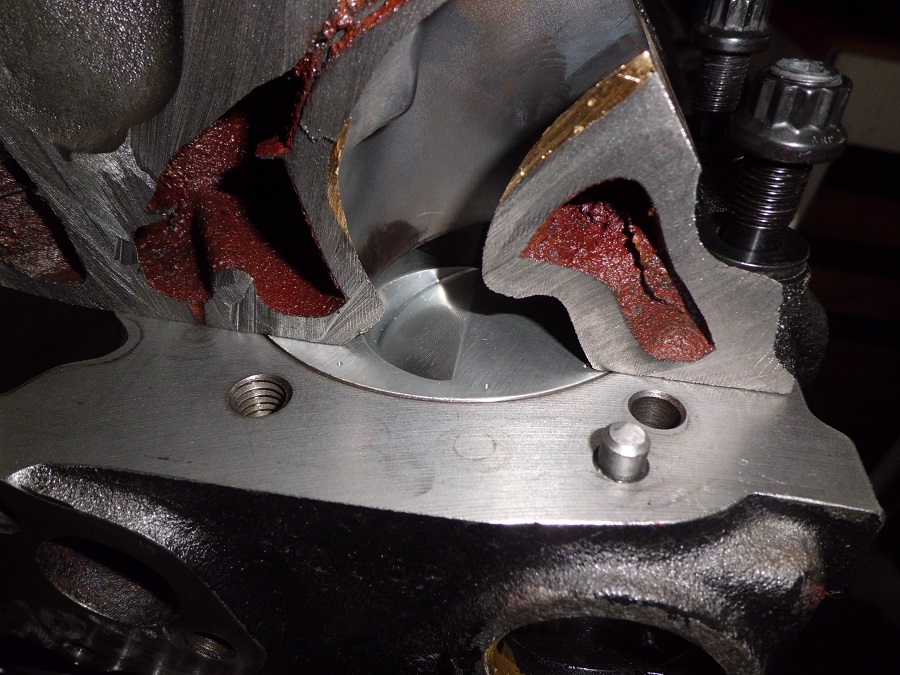

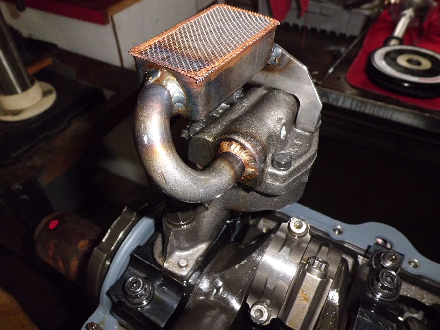

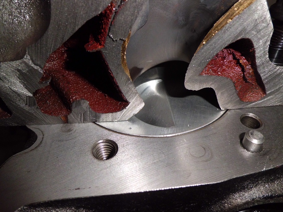

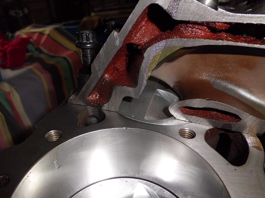

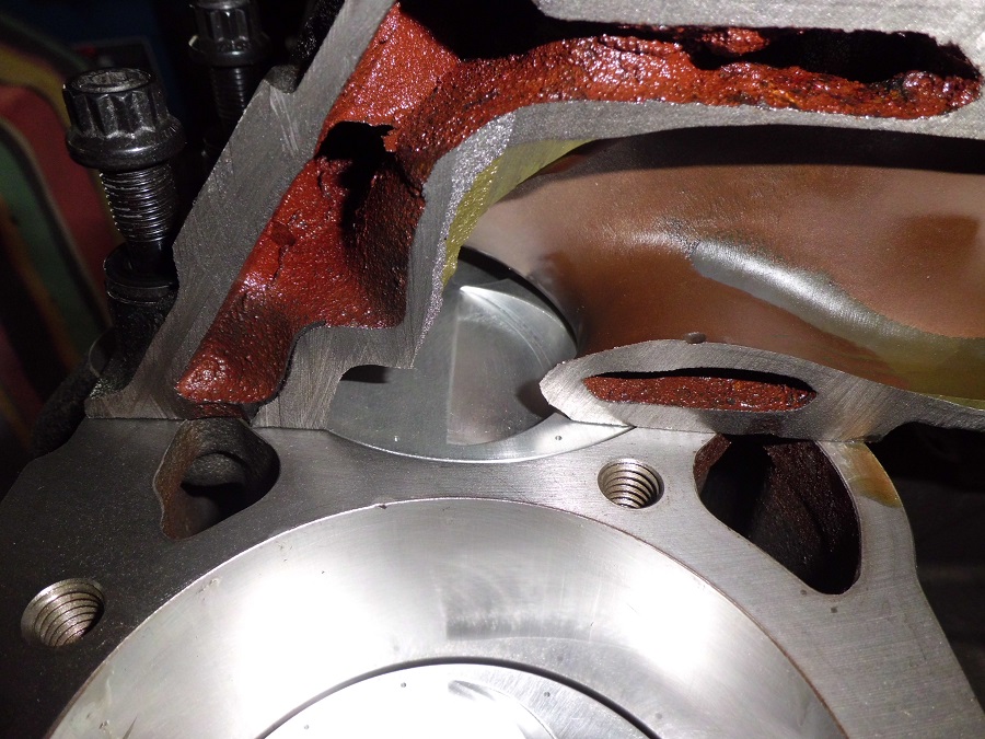

I like good looking welding, gives me a smile.
And I like views not usually seen. Next pics will have valves in place.
ID:	34133   Click image for larger version
ID:	34134   Click image for larger version

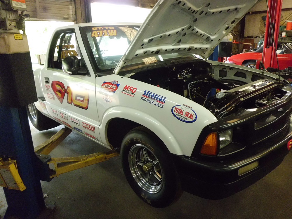

YEA! Look what is out of storage and back in the shop
Larry Woodfin 471W

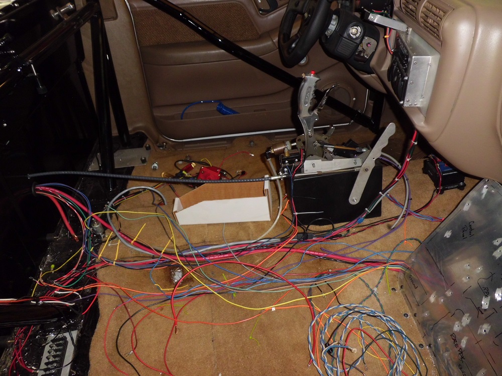

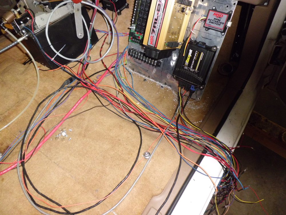

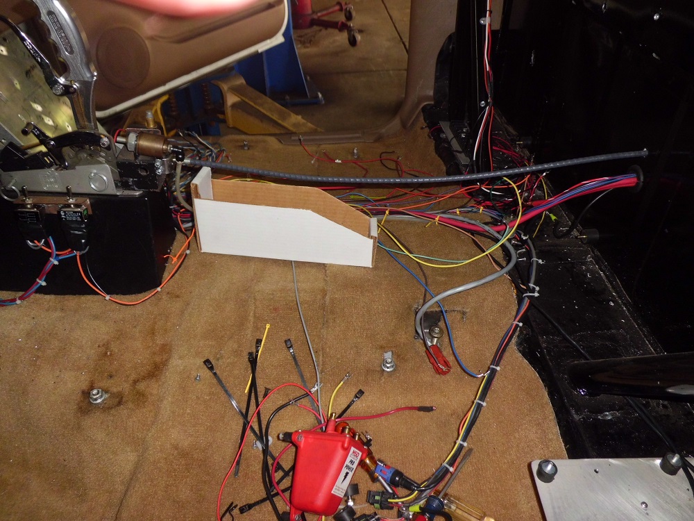

The wiring is being completely revised. These are the "before"
ID:	34141   Click image for larger version
Larry Woodfin 471W

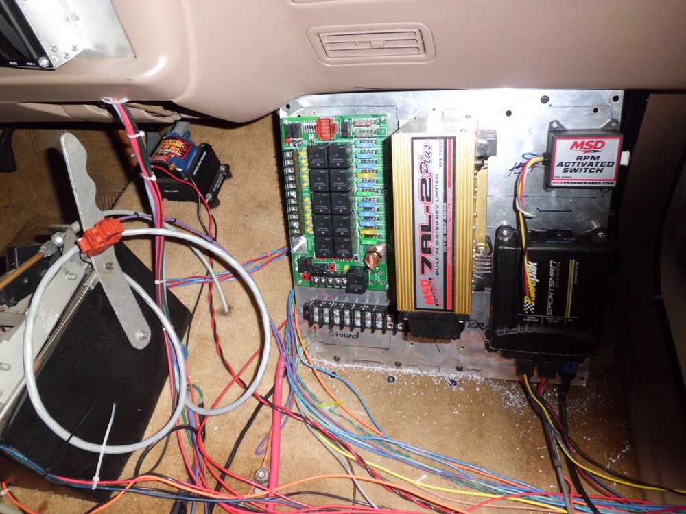

Saturday morning progress. Most electrical components remounted and ready for wiring runs.
Larry, is that a pre-wired relay board where you just plug in the switch and source wires? If so where did you get it? I have a small one that looks similar to clean up my electrical next off-season.

Dale,
I will ponder your question and get back to you.
The relay board is part of the Digital Delay package that includes the dash switch controller that is also the dial-in display module. The dial-in showing on the switch panel is also showing on the outside mounted display board. It is a convenient package.
I will have it powered up soon and post photos.
Another relay/fuse board I use and like is "Nitrous Dave's Race Electronics" [or something close to that] He sells just the relay board to use with your switches. It is a good product and good value.
More soon.

hey Larry in order for the g meter in your racepak to work properly. it has to be mounted flat and pointed in the direction of travel. standing it up like yours is not good.
Mark Markow

Mark, I knew that and forgot, Thanks for the reminder. Originally I had it mounted correctly but, "revised/improved" the mounting
I appreciate the catch and will change to "revision" three.
