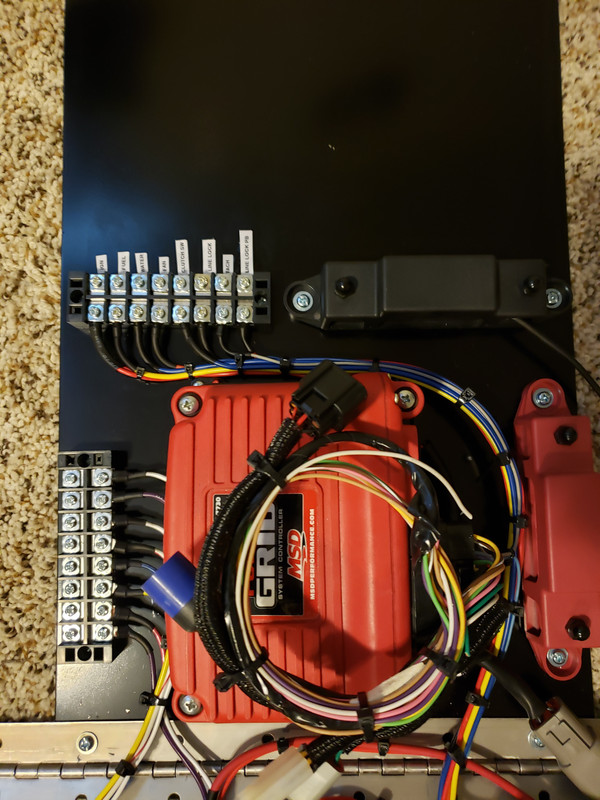

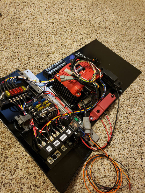

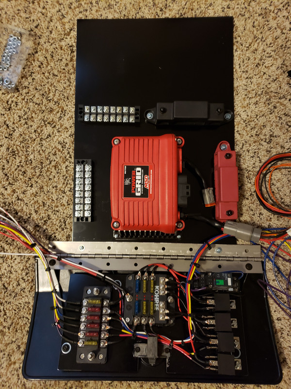

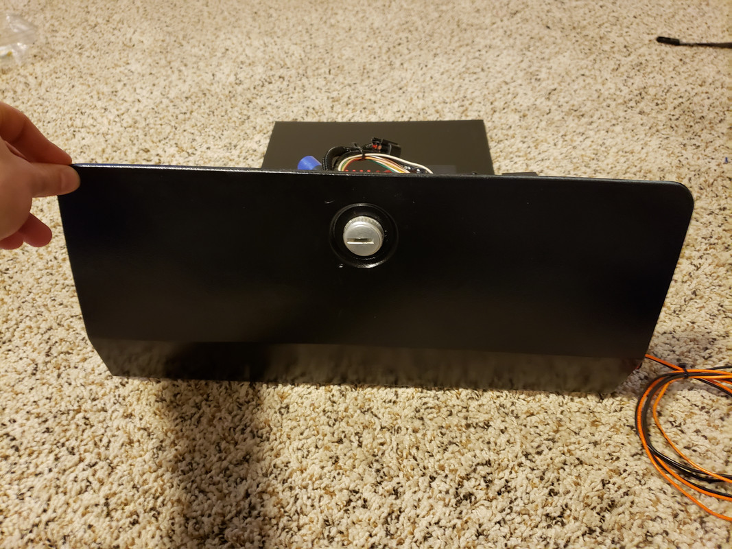

Default Re: 79 Malibu- Stocker-Stick Shift
With the crazy cold temperatures rolling through, about the only thing I could do was get started on the wiring. You'll see I updated the print with some revisions. One in particular being a DPDT relay added to latch the line lock on for staging purposes and releasing once the clutch is released. This also allowed me to wiring in the burnout rpm separate from the launch rpm.
All electronics will be where the glovebox was.
J518 is offline   Reply With Quote

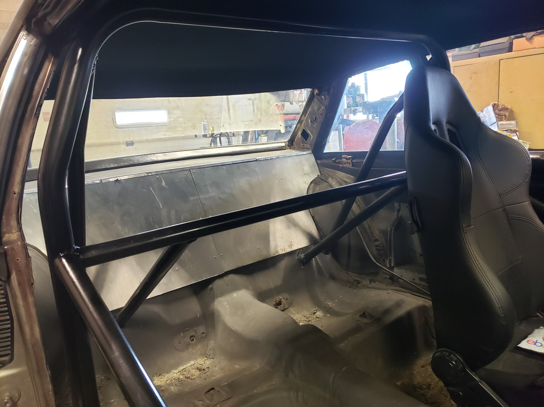

a pontiac
Posts: 65
Liked 36 Times in 11 Posts

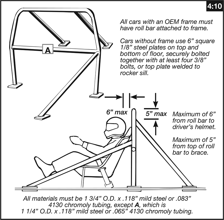

I think you need 2 bars running from the top of main hoop to the rear frame. I maybe wrong might check rule book.
I checked back in the book (I run a 10 point cage), and this is correct. This car has the crossbar angle braced but not the top hoop. Here's a pic from the 2020 book:
Thanks guys. Looks like you're correct. We'll add it to the list!
Looking back, can't believe we missed the main hoop support bars but thankfully it was brought to our attention before the interior was in.
So thank you!
We made quick work with a saturday afternoon and added two bars.
