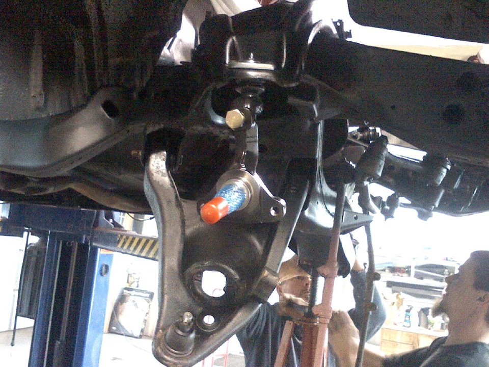

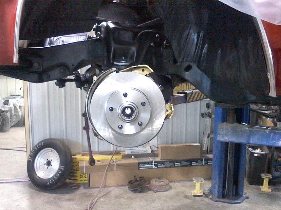

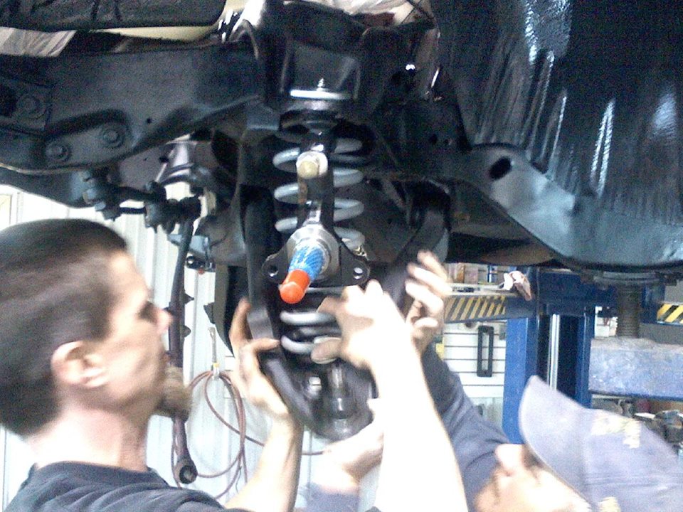

ball joints, disk brakes, springs.

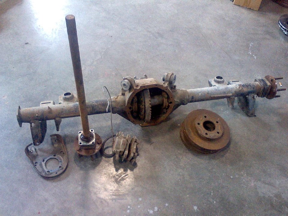

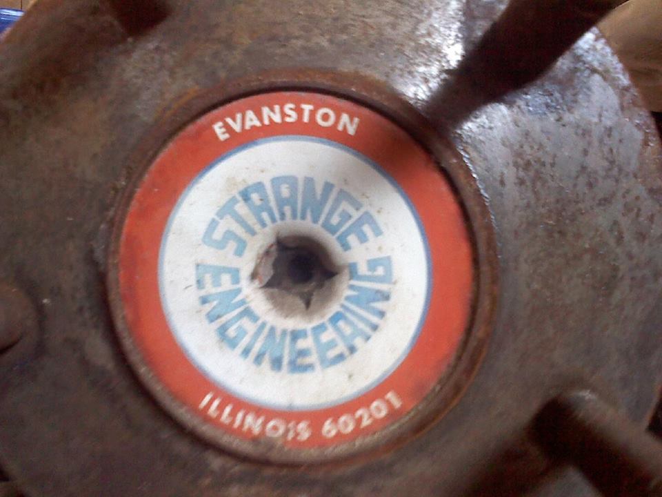

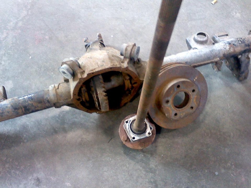

Rear end problem solved! Barn find. 12 bolt for a 1964-1967 chevelle m-w spool, 4.88 gear old school strange axels with disk brake set up... Ok my buddy was at a guys farm yesterday looking at a old ford pickup he wants repainted while looking at it in the garage he tripped on something. A 12 bolt out of a old drag car! I can't tell you what i paid. But i felt like I robbed a bank or something. Its a little rusty needs a cover and gears and paint!
