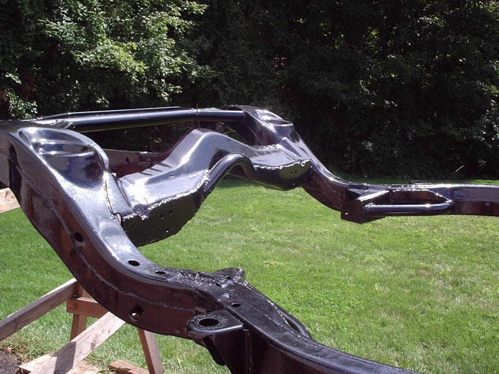

Here is gusset work started on the frame. This is how a big chevy lives without part breakage. The rear upper control arms crossmember is the most important to fix. The rear tends to pull them out if not strengthen.

How about a similar setup on the uppers, after re-welding of course ?
