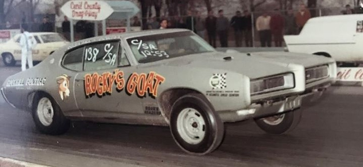

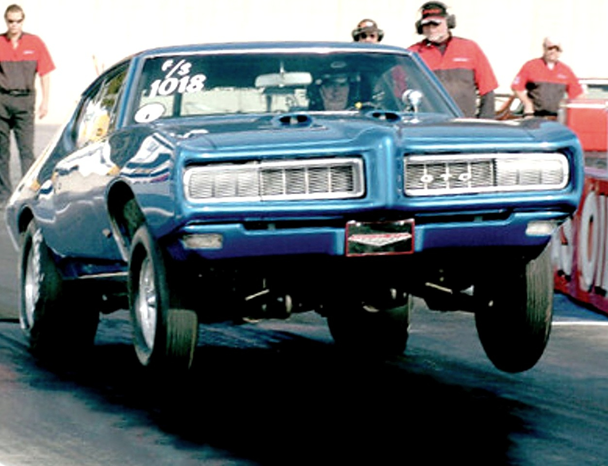

"... with the different throttle linkage bracket..."
Yeah, those Q-jets were rigged up so they would not open all the way. But, that was easily fixed by hot rodders & racers.
On a Pontiac forum, I've been scolded for not posting pics to go along with what I was saying. I suppose that's one reason why I have collected so many Pontiac pics on my computer.
I think MOST guys like pics. At least I usually see several guys thanking the guys who post pics from races.
I don't care about MOST of the pics. But, I always like to see pics of the few Pontiac powered cars that are still active.
I assume that Adam Strang & Tim Gillespie have driven the quickest '68 GTO Stockers, ever. Tim Made the field at Indy a few times. He was #83 in 2006, @ .981 under. Adam was #105 on that list, but had already switched over to his '68 Bird. Tim also later switched over to a '68 Bird. Julie Biermann has been driving it for the last few years. It now runs high 10's.
https://www.dragracecentral.com/DRCS...r2006#indextop
Don't know the best time for either of the '68 Goats. But here's a 2004 race where Adam ran more than a sec under. He ran it mostly as a stick car. Won class at some races.
https://www.dragracecentral.com/DRCS...r2004#indextop
