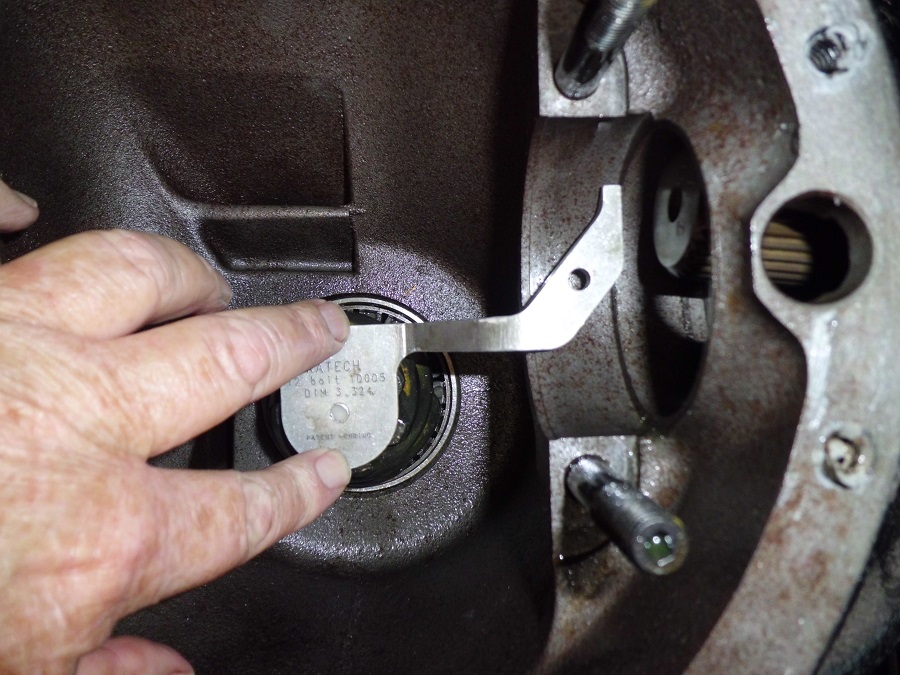

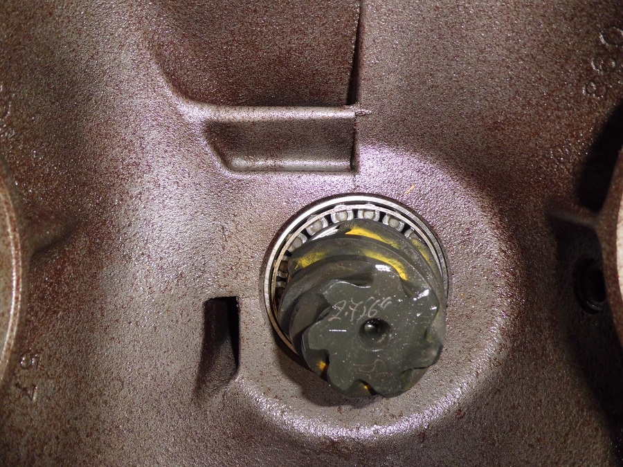

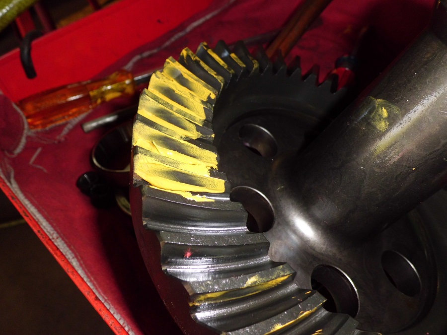

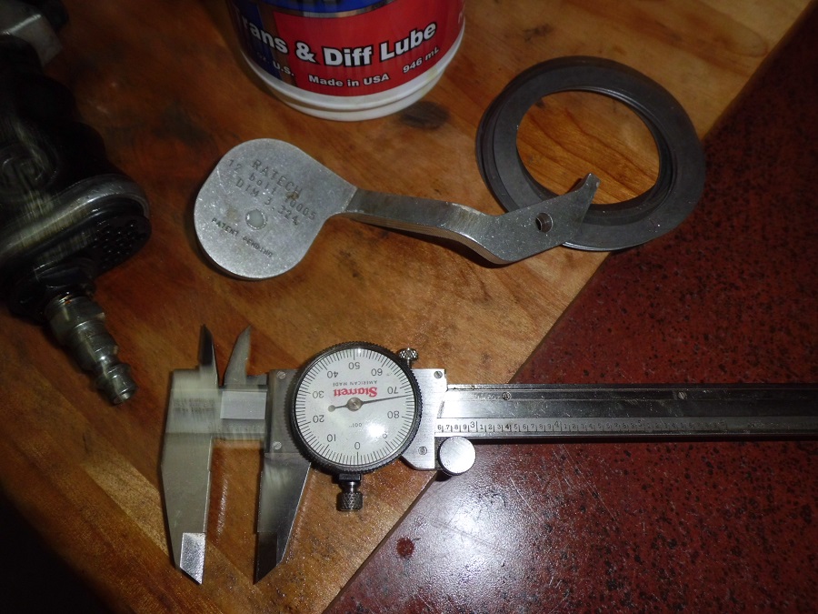

First, the broken intake valve is my fault. I knew the valve to piston clearance was border-line too close yet thought it would be OK. Also, more than once I let the engine get away from me in the water. The 327 likes RPM and in the water the gas pedal just kinda falls away from my foot It will get on an 8800 chip before you can say don't do it.
Lessons are learned and adjustments made. The rebuilt engine will have "enough" clearance and the driver will do a better job of RPM control.
Second, the 6.0 rear gear is slightly too much at the finish line. I am changing to a 5.86 gear and that will lower the finish line RPM by about 200.
The 6.0 gear was a Strange/US gear that I sent to have REM and Cryo treated.
With the 5.86 I decided on a Richmond 9310 series and installed it out of the box. I like the Richmond better. It setup right on the money and has a good pattern.
Photo #108 shows the pinion depth setup tool on place.
Photo # 107 shows the dial indicator reading that means the pinion depth is exactly as etched on the pinion.
Photo # 109 shows pinion dept number
Photo #110 shows desirable gear pattern.
And another in hind sight observation. My race experience with a Chevy 12 bolt has been good. I have built and installed a number of 12 bolts and all give good service.
However, because of the steep gear need with the Super 10 the 12 bolt pinion becomes very small. I now realize a 9" Ford would be a better choice when selecting the very low ratios.

Larry I always set the pinion depth a little deeper into the ring gear to make them last. The 12 bolt deflects so much it will actually move to a more correct patter in use. I also set the back lash a tick tighter. Doesn't give a good pattern but the small pinions will last and not fold over as quick. I assume you do away with the crush sleeve and use a solid one, Aye! OH and I don't use shims behind the pinion bearing. I have seen them have a nasty habit of coming out on decel at 8600. Shim behind the rear pinion bearing race & case.
