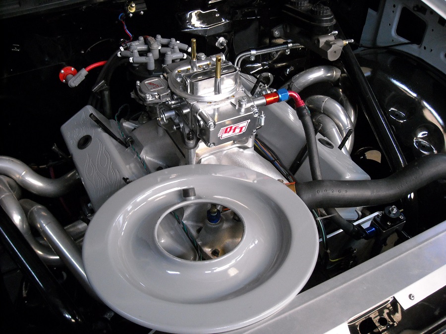

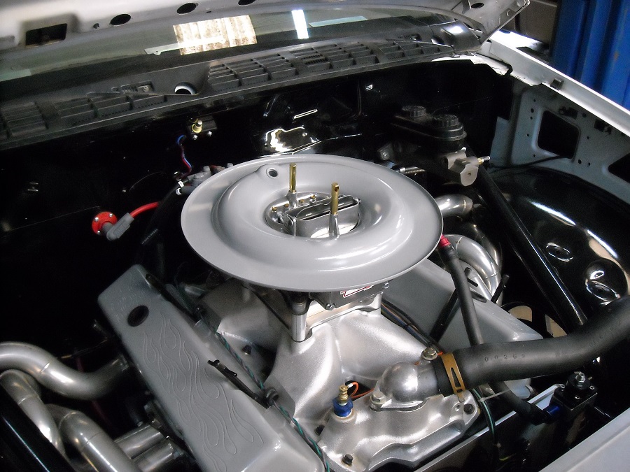

and speaking of learning about details, I learned today that this air pan furnished by Dick Ullrich is OK to run.
Thanks Dick, I appreciate it.

Default Re: Woodfin's SS GT/TB construction series
Dale,
the Quick Fuel folks are polite and helpful and I have established a relationship with them. The products perform as expected and are of good quality.
And yes, I think the SS585VS is a good choice. It is a current [new] design as compared to older carb options. Quick Fuel added a fuel metering curve specific to my combination and it ran excellent right out of the box.
I did take the bowls off before running it to verify the jets were per the flow sheet. [and they were]
The one thing I overlooked, it did not have the vent baffles installed. At the track I had a stumble at launch and quickly expected fuel was slashing out the front vent and momentary flooding the engine. The old rubber fuel hose looped between the vent tubes saved the day and it ran perfect.
Back at home I installed vent baffles and taller vent tubes for the next race. Look back about 1 or 2 pages and you will see the mods.
Next time I talk with QF I will tell them this story and suggest an upgrade that would include the baffle and taller tubes.

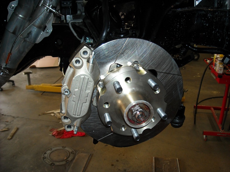

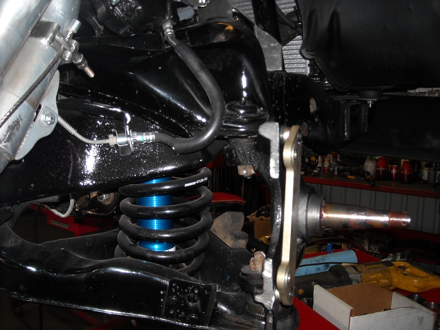

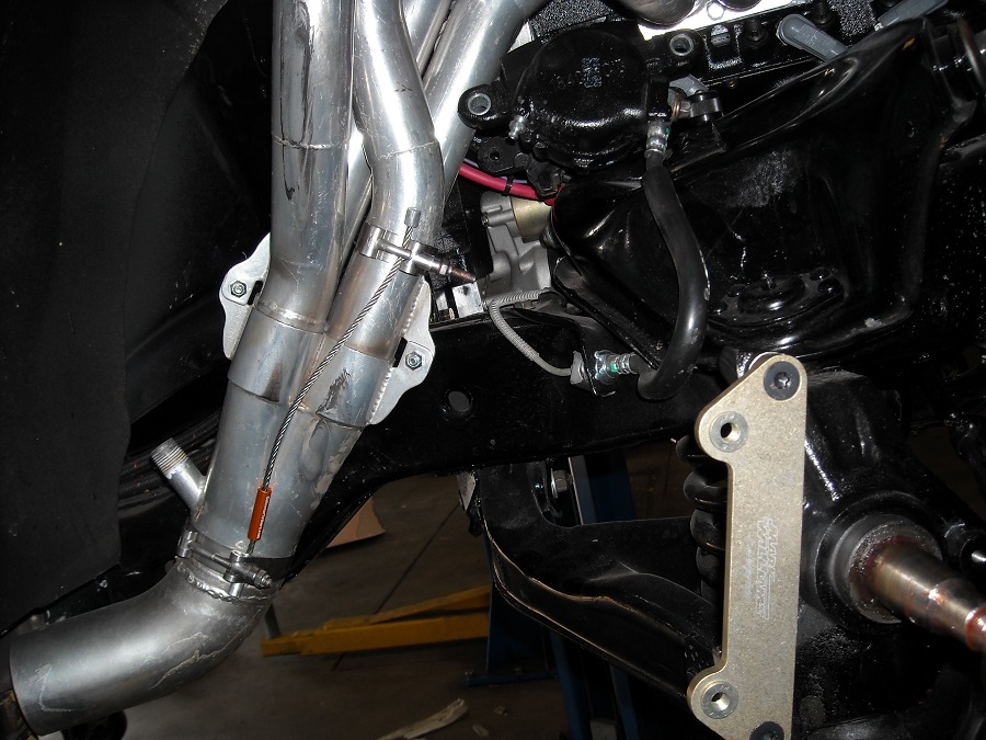

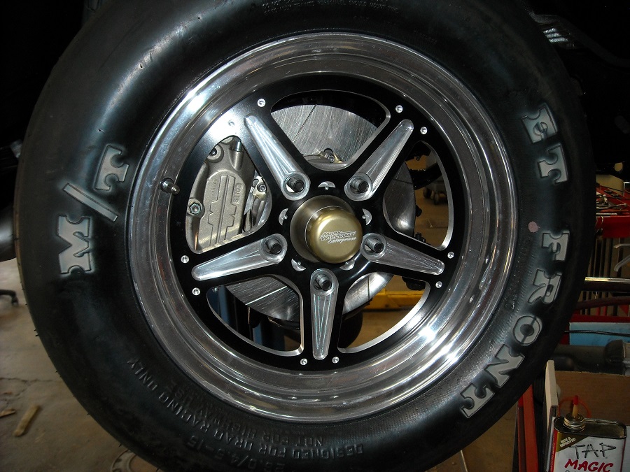

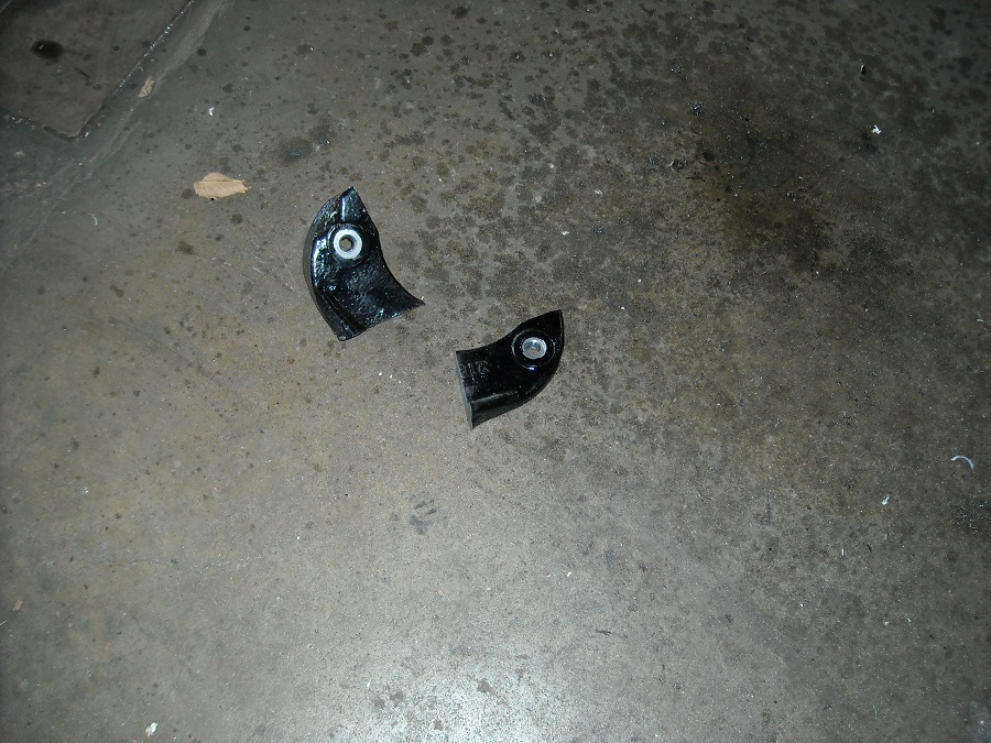

Sunday is shinny parts day!
Notes:
#281 Tethers and caliper bracket
#282 "Ears" cut from spindle to fit MW caliper
#283 shows the "trimulating" of the spindle
#284 rotor and caliper in place
#285 Yea for shinny parts
ID:	30207   Click image for larger version
ID:	30208   Click image for larger version
ID:	30210   Click image for larger version
Larry Woodfin 471W

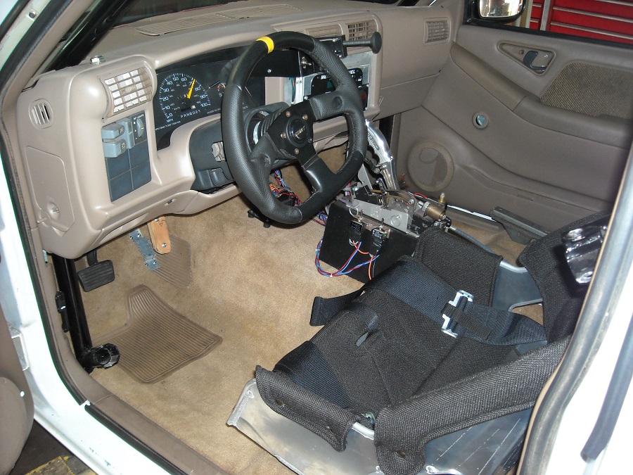

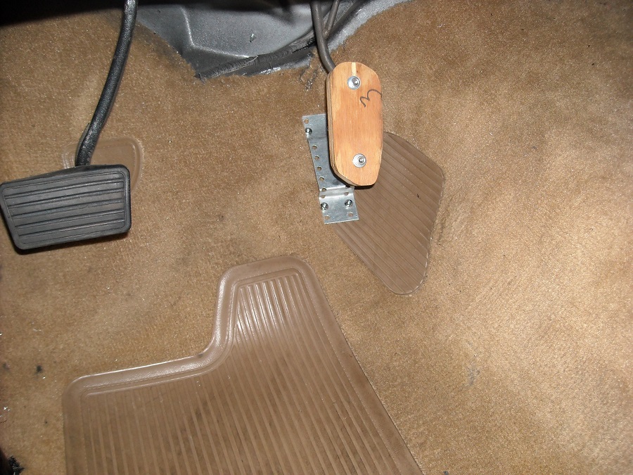

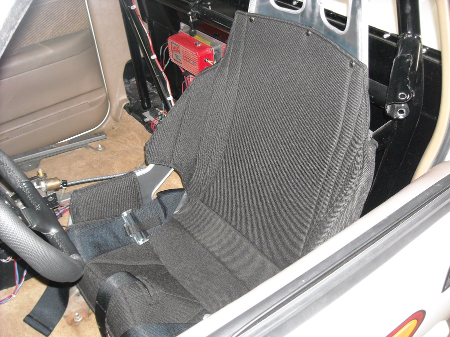

During the course of this build a number of folks have complemented me on doing a neat, quality job. I appreciate those complements and I do strive to perform in that way.
However, I am at heart an East Texas blue collar mechanic and every now and then I must embrace that heritage.
Case in point, with the removal of the factory seats and installing of aluminum race seats I was careful to duplicate the factory seating position because it fit me just right. Once installed, the seating felt good and steering wheel spacing was good. Yet, the gas pedal feel was not just right.
Some work with a table saw and belt sander cured the pedal issue
Larry Woodfin 471W

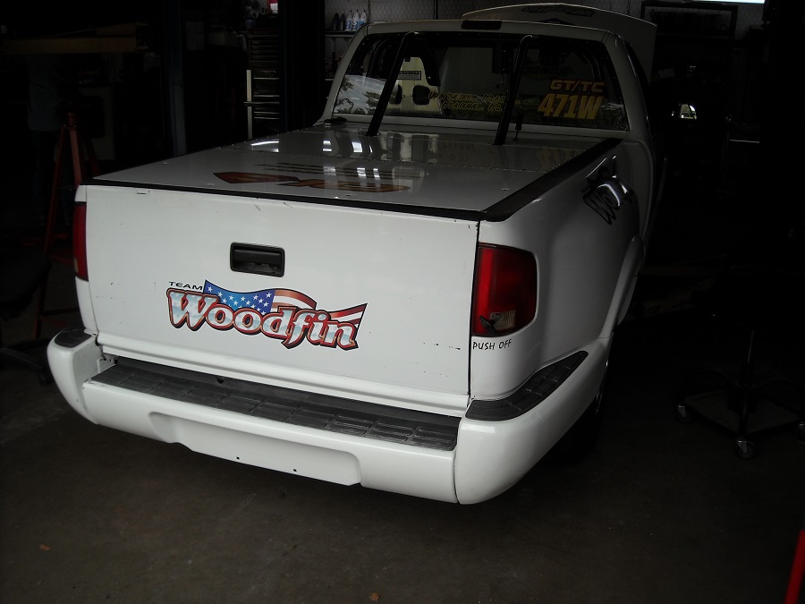

We have the factory bumper reinstalled along with one seat. More soon.
ID:	30311   Click image for larger version
ID:	30312   Click image for larger version
Larry Woodfin 471W
Old 09-02-2015, 12:41 AM   #470
FireSale
FireSale's Avatar
Join Date: Feb 2014
Location: Lakewood Washington
Posts: 1,407
Likes: 29
Liked 237 Times in 126 Posts
The spacing between your brake and gas pedals seems huge compared to my Mustang. Is that stock? My truck's a stick so I don't have a reference point. Wife drives a - gasp - Subaru...
