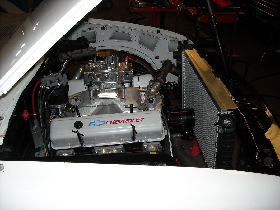

Yea, the Super 10 is alive! Spun over couple of times and fired right up.
Sounds great, just like a real racer. Everything is looking good. No oil or fluid leaks, oil pressure as expected, idles good, throttle is sharp. Did a valve lash check after running about 5 mins, all is OK, nothing changed.
Powerglide operating correctly, all gears and trans brake normal operation.
One thing that gave me a smile, with the 1.98 low in trans and 6.0 rear gear at about 1200 RPM idle in low gear the rear tires are moving rather slowly. I think pit road speed limit will be easily conformed
Larry Woodfin 471W

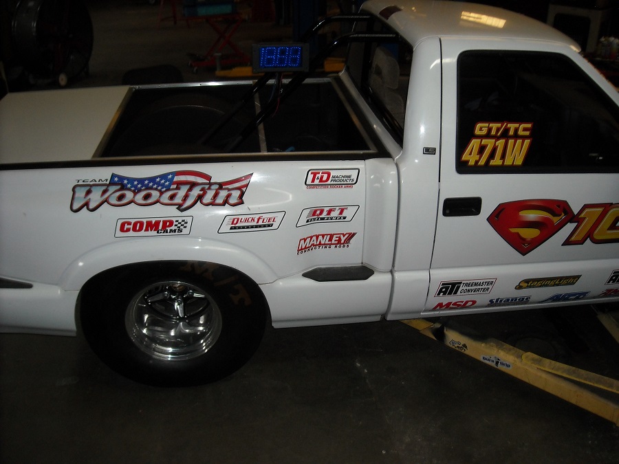

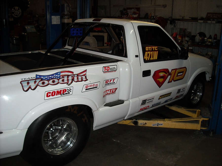

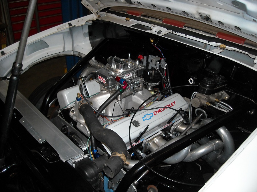

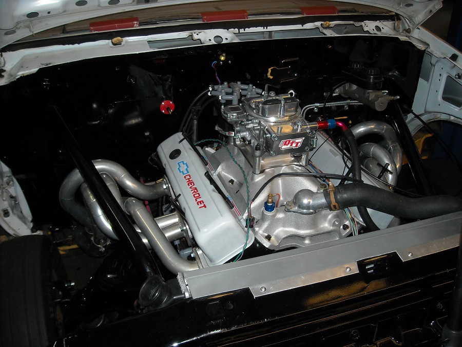

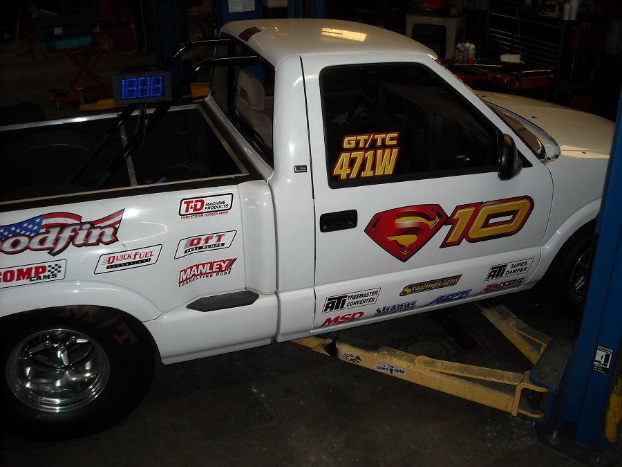

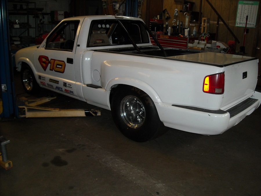

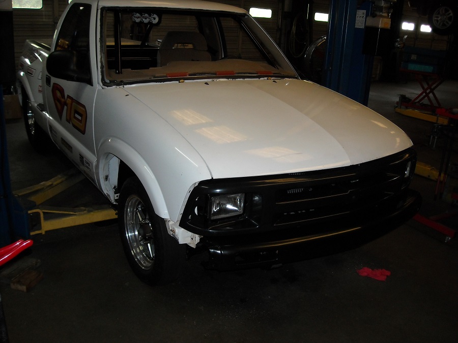

Serious progress
ID:	29455   Click image for larger version
ID:	29456   Click image for larger version
ID:	29458   Click image for larger version
ID:	29459   Click image for larger version
ID:	29461   Click image for larger version
Larry Woodfin 471W

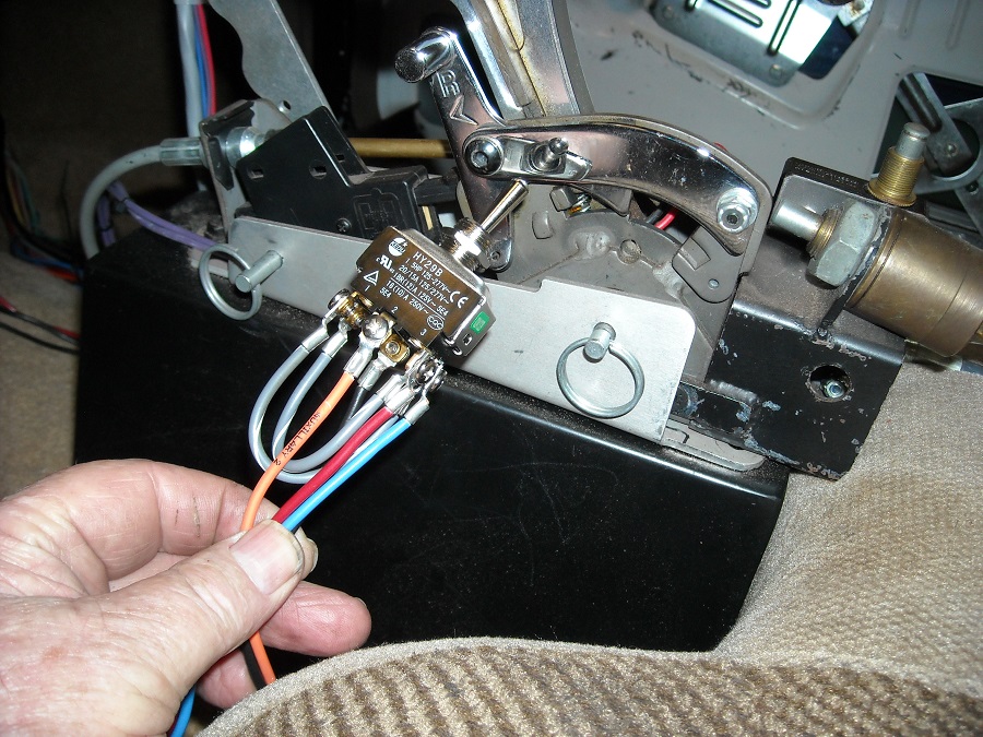

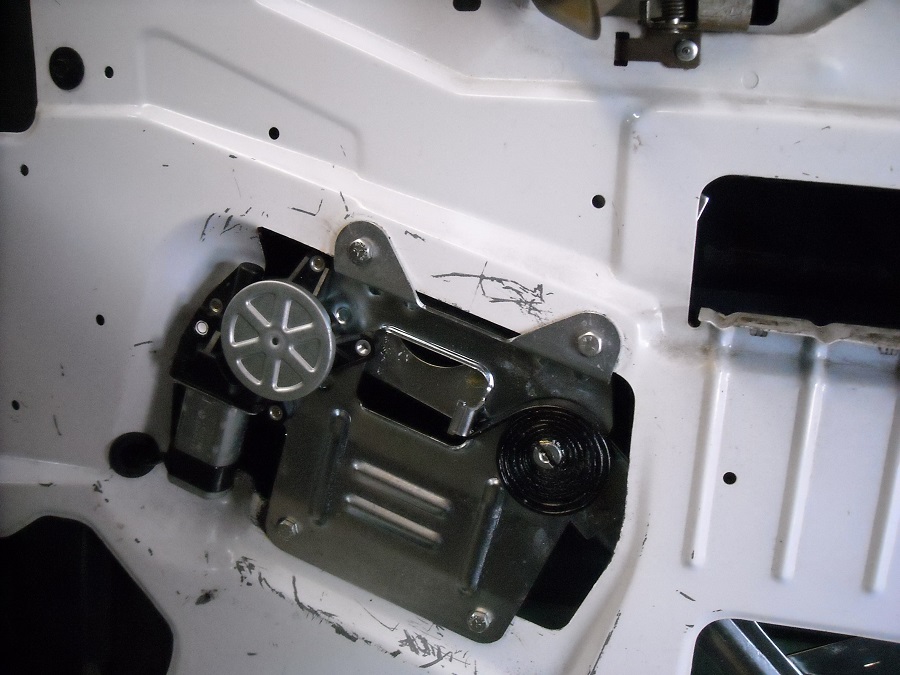

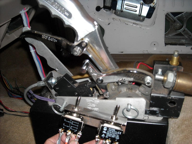

Comfort and convenience when in the "command center"
Out with old fashion crank up windows ! In with new Delco motor/regulator assemblies. Parts from an S - 10 Blazer are a direct bolt in.
Finding door switches and wiring harness would require scouting the U Pull It's but I have no desire to spend time doing that.
Instead, source two DPDT momentary switches on - off - on from local store for $9.00 each. Then build a custom harness and switch mount. Total time for wiring and switches about two hours. I would still be at the U Pull it.
