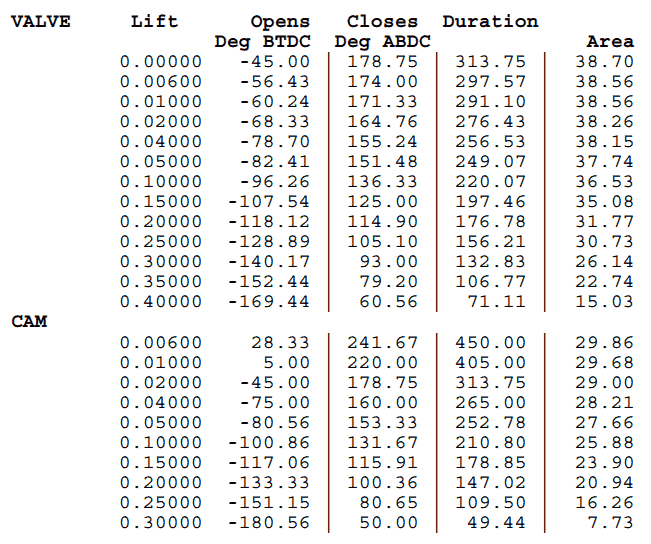

A few things were done by Lunati. NHRA checked lobe lift. The Chevy cam used a valve lash of 0.030" By reducing the lash ramp height they were able to add both duration and lift. Also if you look at my original post you will also see a picture and how dwell was added at max lift.
Stan
Great thread thanks.
I thought the "stocker" (cheater) cams would have more duration at .050 though. Looking at the graph on pg8, it looks like the .050 duration is about (295-55)=240, which is actually less than the stock early Z28 duration of 254 at .050, right?
I get the idea, and that thread discussion confirms it - I just thought the graph would show fatter numbers at .050 and even .100 lobe.

That graph is based on numbers I got using a degree wheel and dial indicator. Not only was that cam raced but it also had a number of miles put on it from street diving. The car / cam was not mine. I just got to work on it. This was in the early / mid '70s. So not sure how this cam relates to the late '60s. At this time a similar engine / car from the same build ran in the high 11's. I don't remember what this car ran.
These numbers are from from the Chevy cam which someone got from a Cam Doctor and was nice enough to share with me many years ago.
Stan
