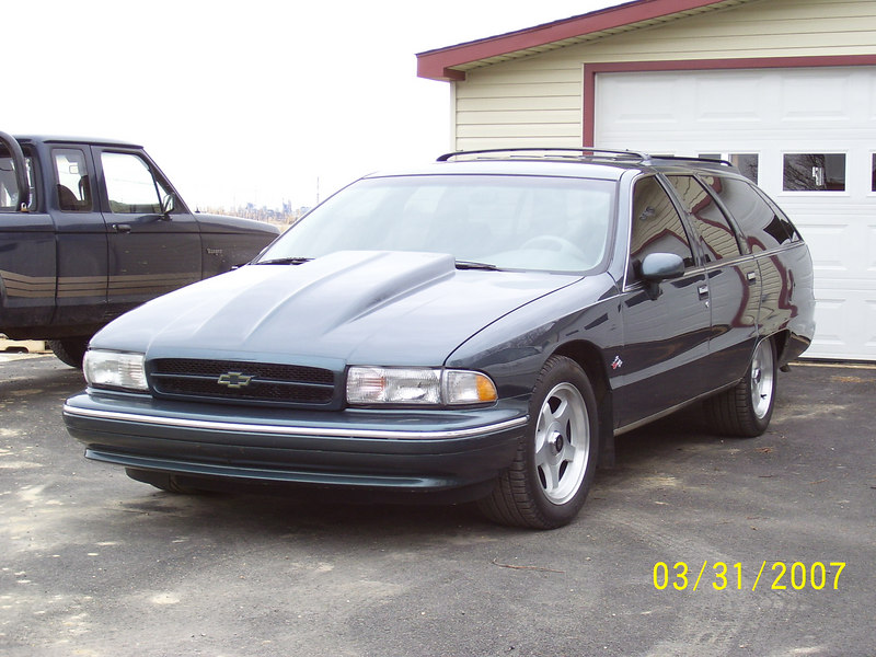

My 94 Caprice Wagon has a set of 2.56's and has touched 24mpg best loaded with family. Mostly in the 23.5 range.
The Impala SS originally had 3.08's and get a best of 23.75mpg. But consistently 23.23mpg.
