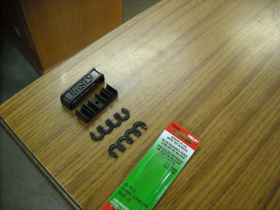

I noticed something good this afternoon. My stock of shiny parts is smaller because they are bolted on the truck
Sometimes the smallest of things gives me pleasure. I like neat plug wires and find the MSD two piece, snap together too bulky for my liking.
Instead, these small "help" looms from the local parts store look just right and fit the wires easily.

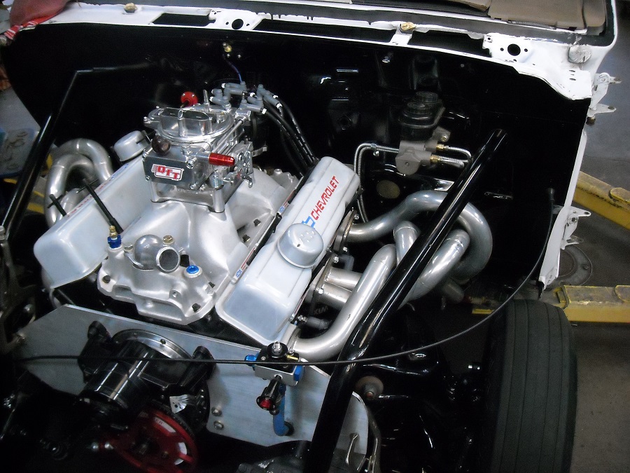

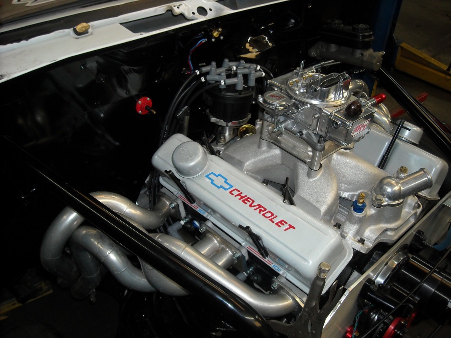

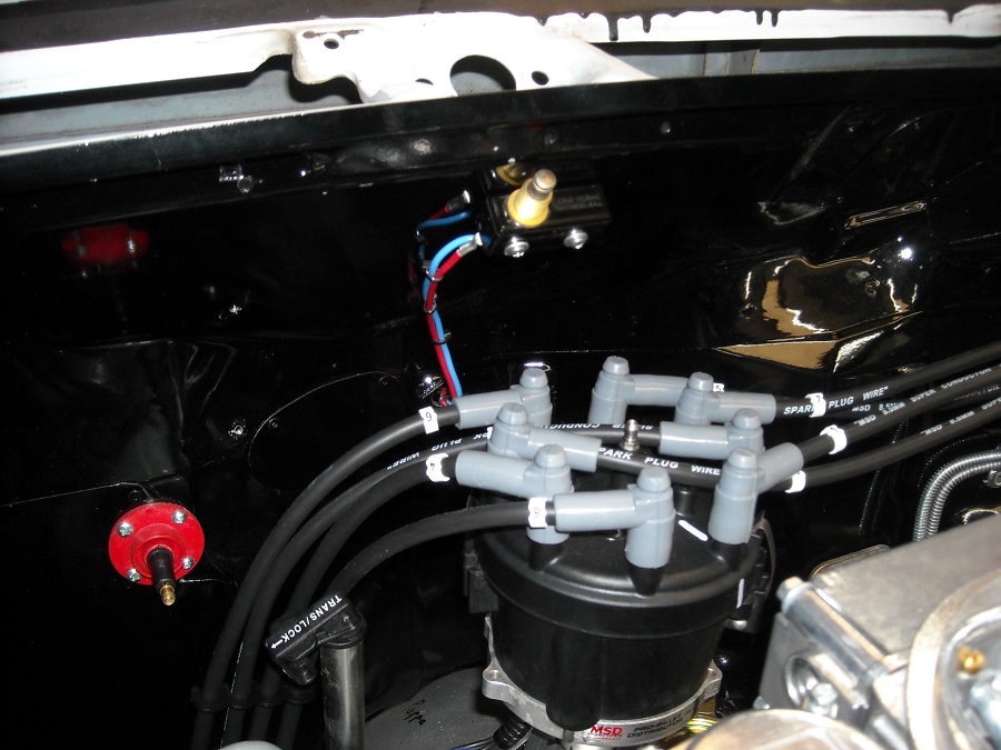

in photo #183 notice the starter bump button
and two more photos of the mostly finished engine

Liked 99 Times in 60 Posts
Default Re: Woodfin's SS GT/TB construction series
Ken,
I think your math is close. I had also estimated 8300 - 8400 engine finish line RPM. Gary Hettler suggested 8200 shift point so it's all fitting about right.
A few recorded runs with the Race Pac will tell the real story
Larry Woodfin 471W

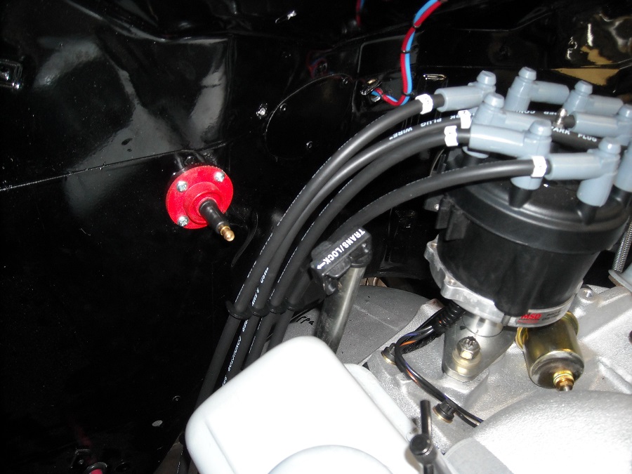

Talking Re: Woodfin's SS GT/TB construction series
Larry,, that starter bump button looks like you could dial in some delay to it if you wanted to! The motor is looking good.

Larry,
Do you have a similar button to bump the fuel pump for fuel check? Just a suggestion.

Sean, good suggestion, the wiring is still working so it will be easy to add that. Thanks, good catch.
A button mounted on the motor place right there by the valve wold be a convenient tool.
