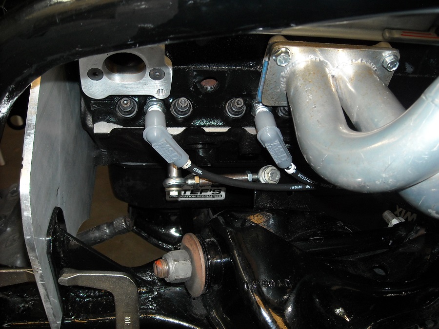

Default Re: Woodfin's SS GT/TB construction series
Being only a bracket racer I have a question about your build. You have the motor plate between the motor and the timing cover and the water pump. Do you have any problem with leaks?
Old 06-06-2015, 08:46 AM   #354
Dragsinger
Join Date: Jul 2008
Posts: 1,760
Liked 99 Times in 60 Posts
Robbie,

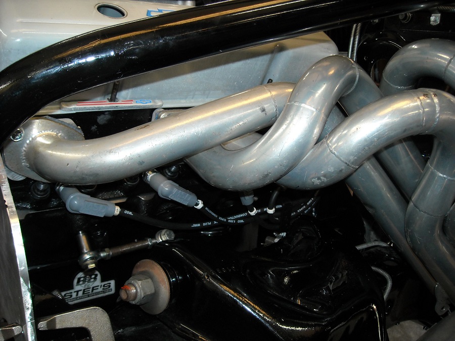

The motor plate install is a common method. It is not part of the timing cover, it is cut out around the timing cover and does not interfere with it.
It uses a set of water pump gaskets on each side of the plate, no problems at all. Many drag race cars and most all dragsters will have such a setup.
I like it in the case of a factory frame build up because it adds the effect of another crossmember. The front plate combined with a rear plate add overall stiffness to the front section. Also, I have not posted the photos yet, there is a "travel limit strut" on each side of the engine. Keep watching and you will see those soon.
Because the Super 10 uses fender well exit headers engine mounts do not matter in ref to header clearance. However, with under car headers that hug the engine block using a front and rear plate and eliminating the side mounts can help header fit.
Thanks for watching and please stay tuned
Larry Woodfin 471W

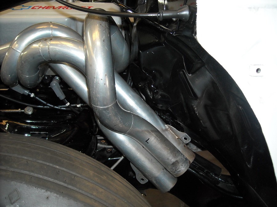

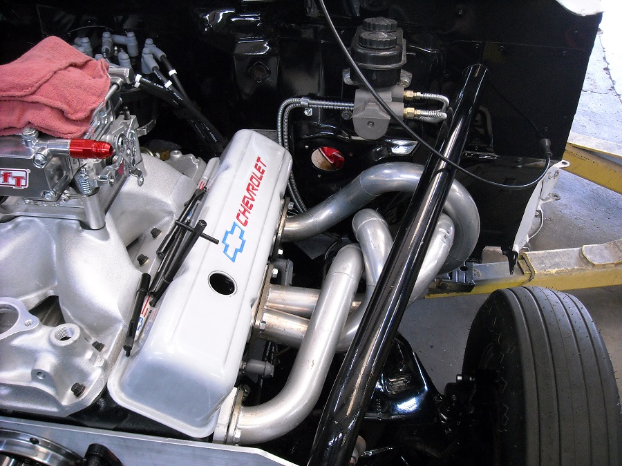

showing engine "strut" & left side header fit.

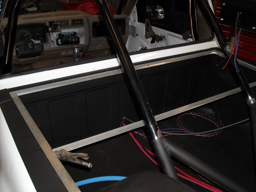

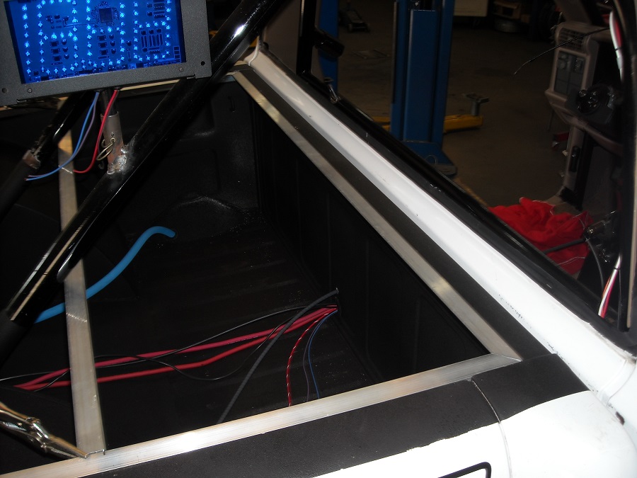

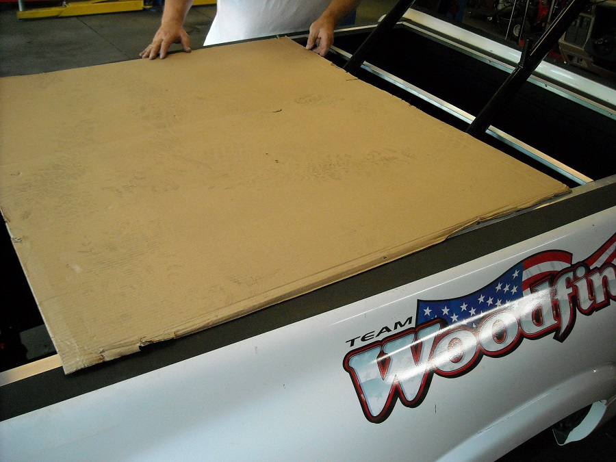

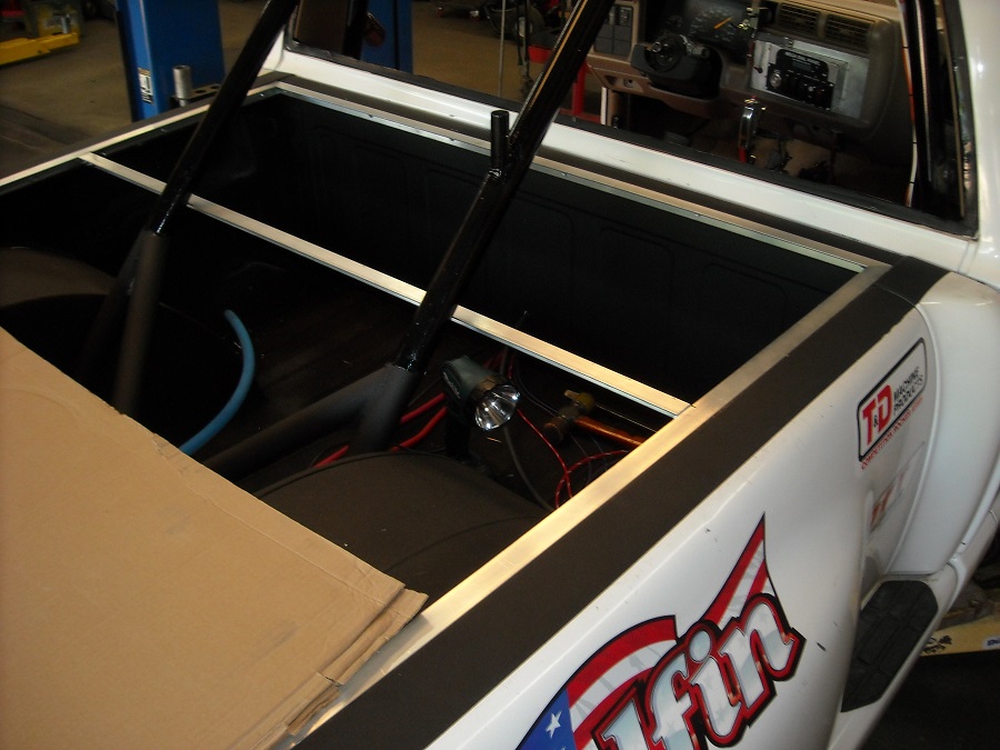

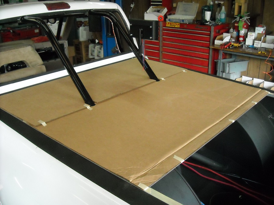

Saturday morning team member Monte came in to begin the bed cover job. We made progress with all aluminum angle fitted and bolted in.
The last photo is the beginning of a panel template. We will use .040 white aluminum in approximately three equal pieces with the last panel hinged for battery and fuel service.

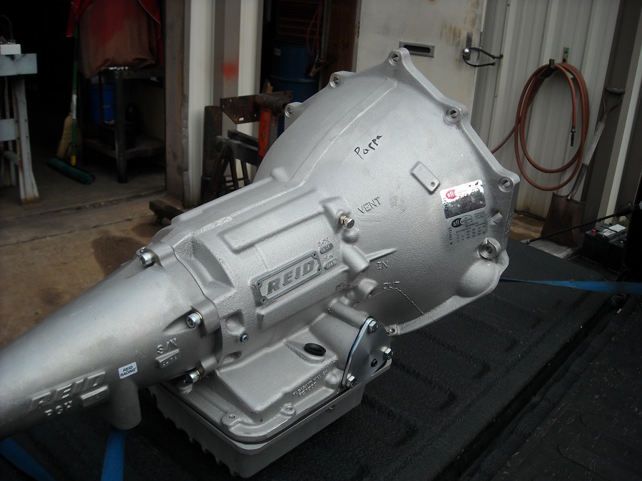

Saturday brings a good work day. The Super Glide ready to be installed

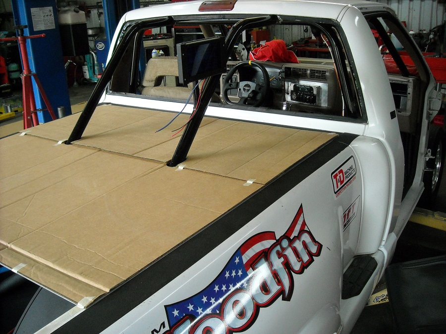

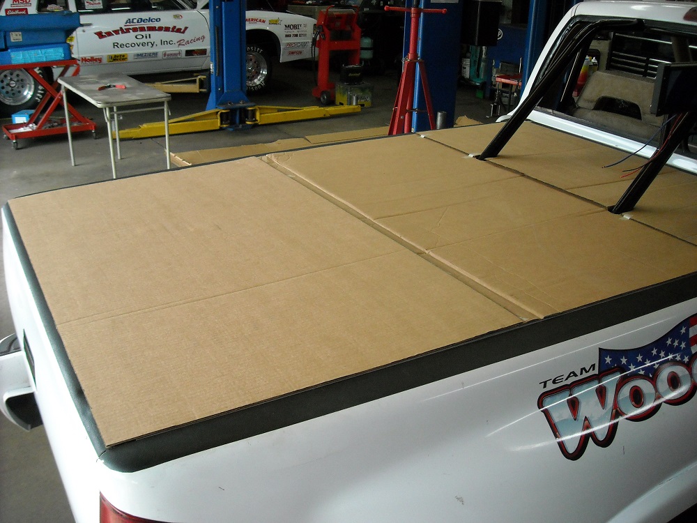

More Saturday progress,

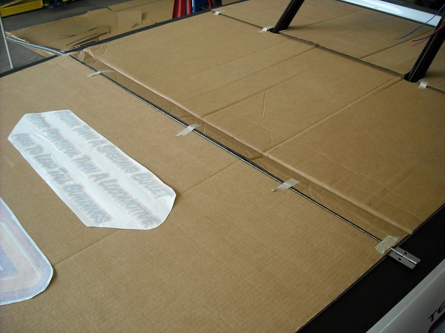

Monte working his magic with patterns for the bed cover.
Also note;
*decal for last panel
*stainless piano hinge
The rearmost panel will have two quick buttons allowing it to open and lay on the second panel. Then with the tailgate down we have good access to battery and fuel.
