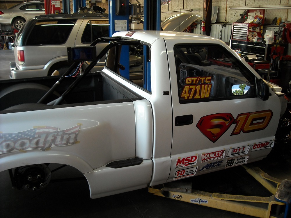

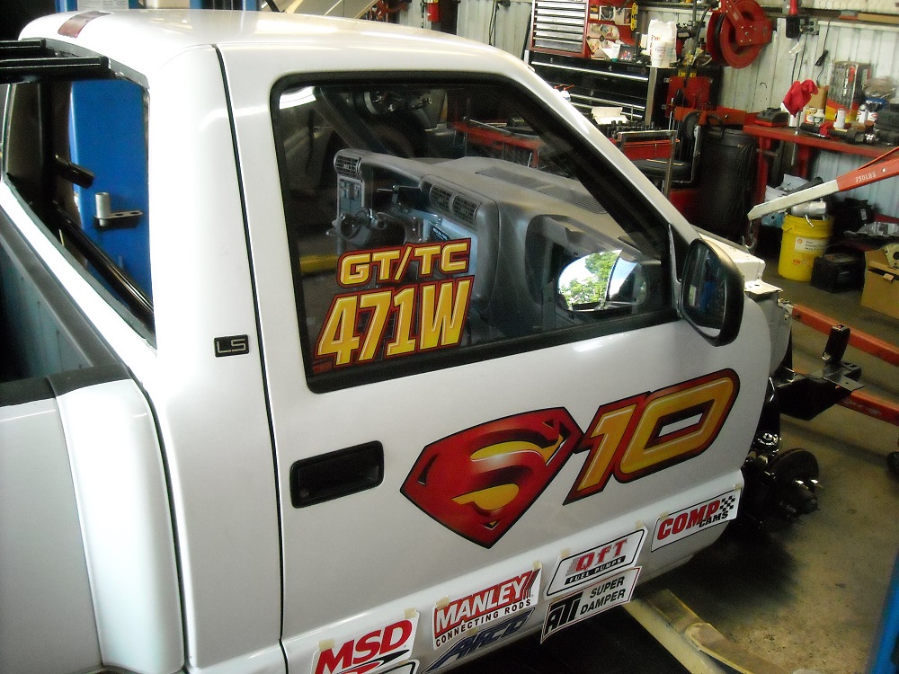

I like shinny stuff
The Super 10 is closer to a race truck each day.

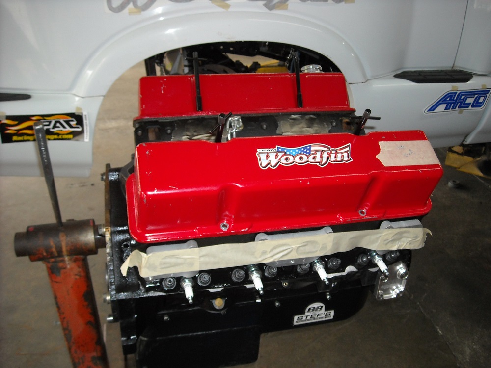

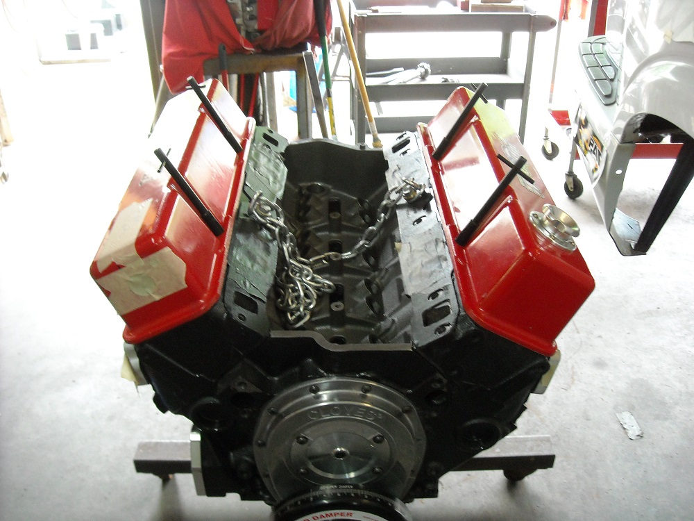

The Super 327 is back on the stand for the finishing details. Senders, crank trigger, distributor, and intake.
It will be finished and back in place shortly.

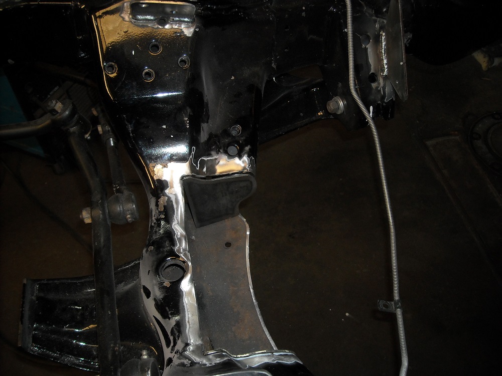

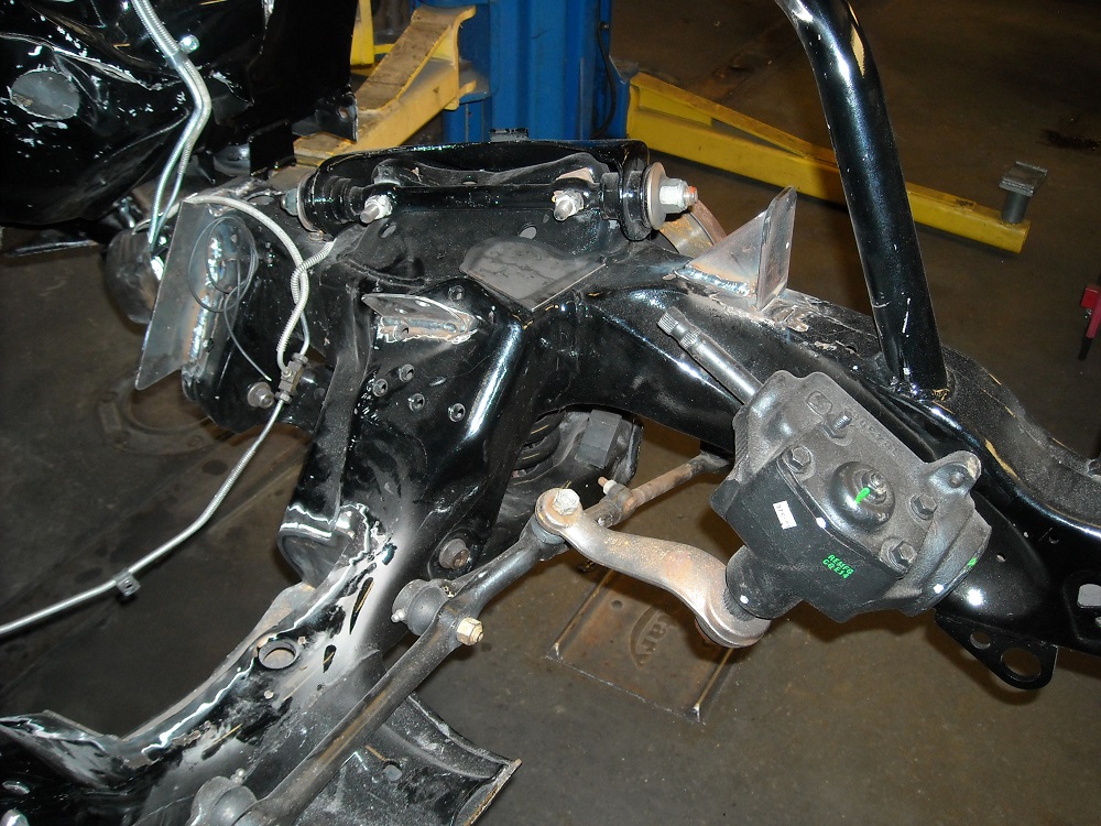

While engine is out for last time we are finish welding/fitting motor plate tabs. You can just see working the crossmember notch.
I hindsight, I jumped the gun with paint work. We have ground and welded a number of painted areas. But it's OK, I have a touchup gun and a paint store just down the street.

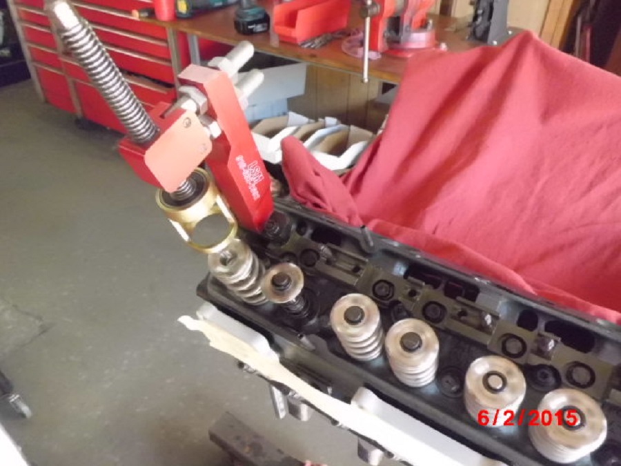

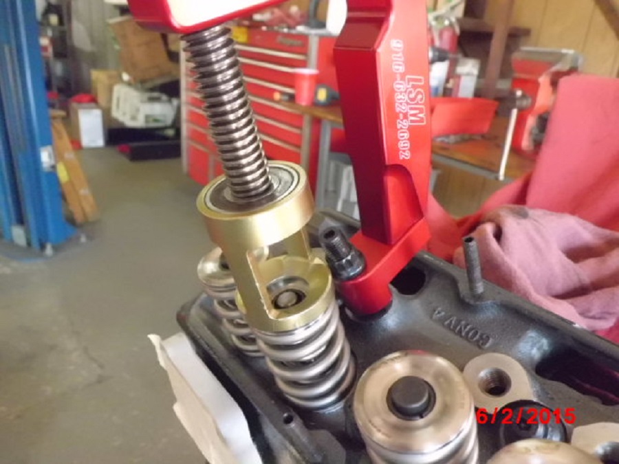

Like our Texas weather the Super 10 build up is heating up.
These two shots show the checking springs removed and the big boy PAC springs going back in place.
Because of how the T & D rocker bar is laid out only some springs can be changed with the shaft rocker tool. No problem, just remove the bar and use a stud type tool.
