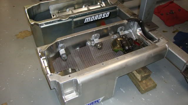

If your going to the Callies crank check into the Magnum XL with a Rem finish these are some of the pics of the crank I got for Jake Stelters build. That engine runs 8800 RPM and won Drag week 2 years in a row.
The short counter weights are the way to go alot less windage at high RPM's
http://s172.photobucket.com/user/bel...ml?sort=3&o=91
http://s172.photobucket.com/user/bel...ml?sort=3&o=92
Some pics of the oil pan.

Seems the trend is away from screens now a days........so which pan is he using? I have the 21017 with the tray in the "pic".

Originally Posted by joespanova View Post
Thats some crank he's got right there.........
Jake is on F/B
