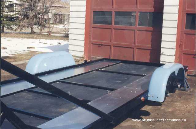

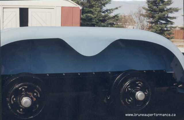

Aubrey, I like your "home-brew" approach...wish I was half as handy as you are!
Just be CAREFUL!
Wondering...on your trailer..if tires are bias-ply...and the load rating?
How much pressure in them....also your normal towing speed?
ss wannabee is offline   Reply With Quote
Old 07-11-2013, 10:16 AM   #26
Aubrey N Bruneau
Aubrey N Bruneau's Avatar
Join Date: Sep 2003
Location: South Eastern Alberta, Canada
Posts: 311
Likes: 6
Liked 7 Times in 3 Posts
Send a message via Yahoo to Aubrey N Bruneau
Default Re: enclosed trailer with 15" tires?
well, SS, I'm not very good at making money, or managing things, but I can design stuff.
Not really "home brew". More like "logical, purpose-built"
Tires are 205 70 14 radials. 44 PSI max, which I run at about 40. I believe they have a load capacity of 1400 pounds each. Weight on the 4 of them, depending on what is on the trailer, varies between 4000 - 4700 pounds.
Normal towing speed on the highway, is 65-75 MPH.
This unit has been trouble free since 1992.
Aubrey N Bruneau 6409 C/S

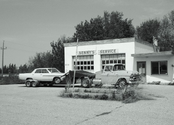

Originally Posted by ss wannabee View Post
Hey....it ain't fancy...but it works! Not bad!
A lot better than the belly button, fit-all trailers that you buy !
naah, it aint fancy
ID:	20007   Click image for larger version
ID:	20008   Click image for larger version
BTW....are you shooting for some 10.90's later this years?
Just got got my new clutch from Advanced. Pick up the block in a couple days.
We'll see. My "adjusted" cam profile, HOPEFULLY allows the intake valve train to be in control. If I do manage to make a fast pass or two, I doubt that it would be "official", because to my knowledge, there's only one more available Stock / Super Stock race out west here this year... and it's next weekend in Mission. Can't make that one.
BTW, my old contraption is definitely not a roller coaster ride ! In fact, with the loaded trailer, my truck is way better to drive. Running through that highway on the east side of Golden BC, is something that I look forward to !
62 BelAir sport coupe, 409 HP 409
