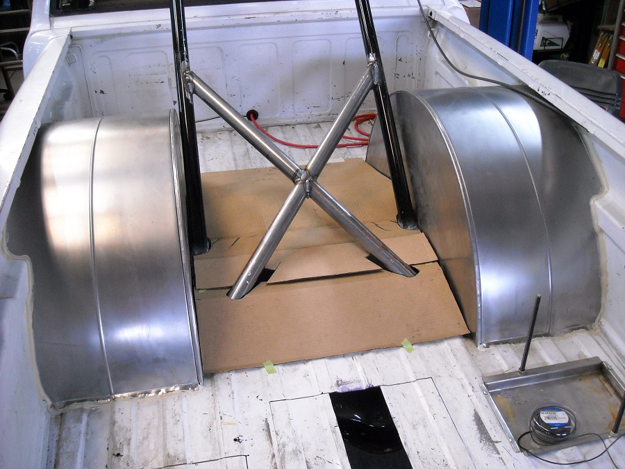

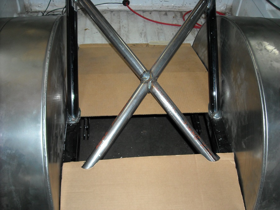

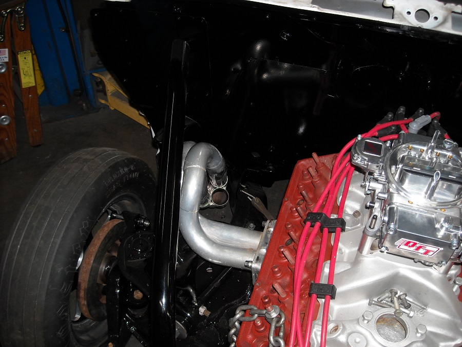

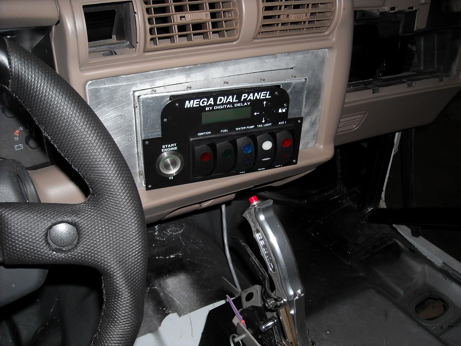

Sunday afternoon tid bits;
*the beginning of patterns to close off the floor
*right side header test fit
*a check of switch panel fit

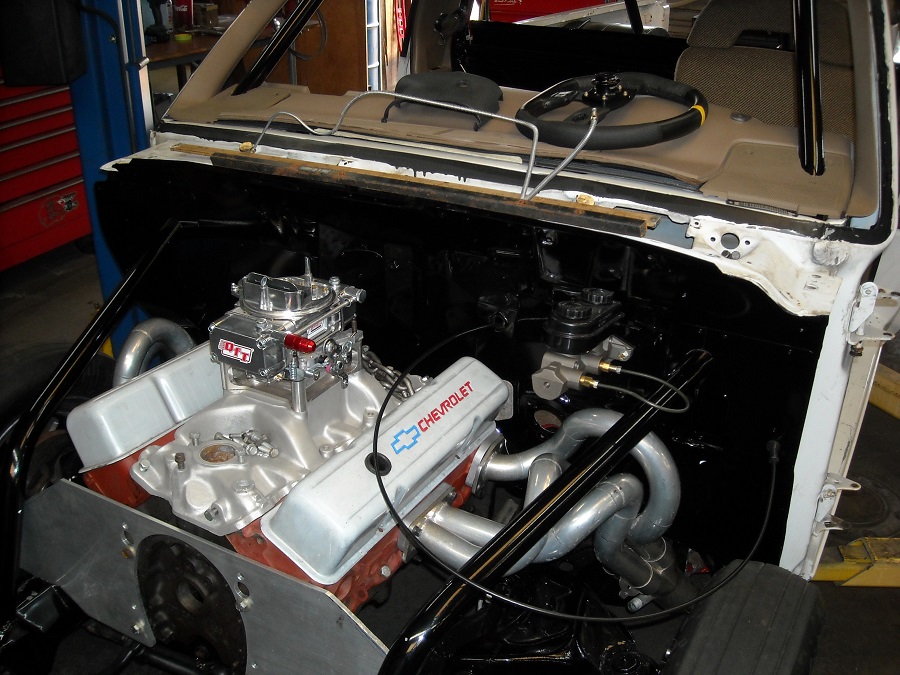

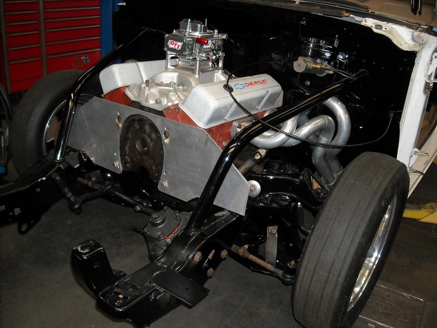

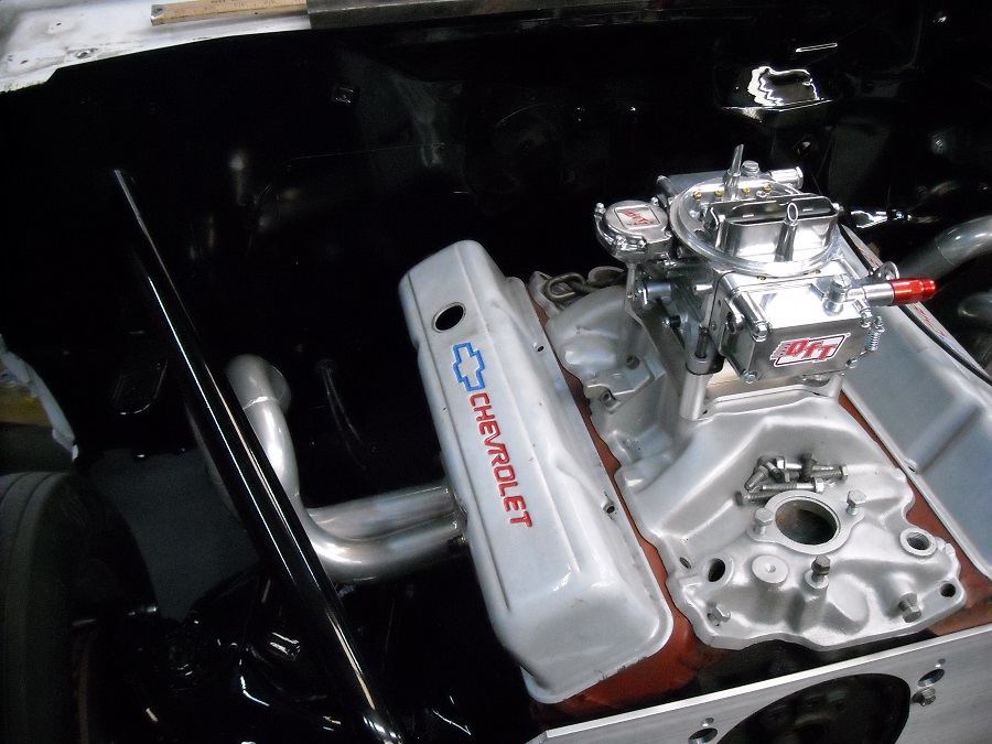

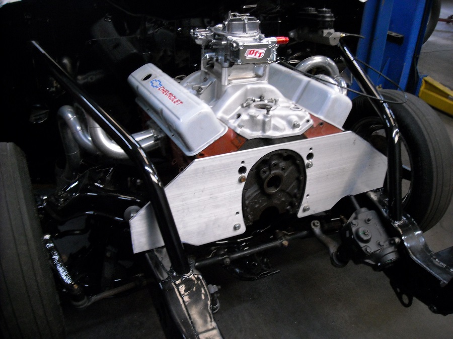

Some mighty fine Saturday weather work day updates. Man O Man, it is soooo good to have some sun and relative warmth [low 60's]
These photos show I am closing in on engine position and header fit. The engine position is a balancing situation between header fit, steering shaft clearance and driveshaft angle.

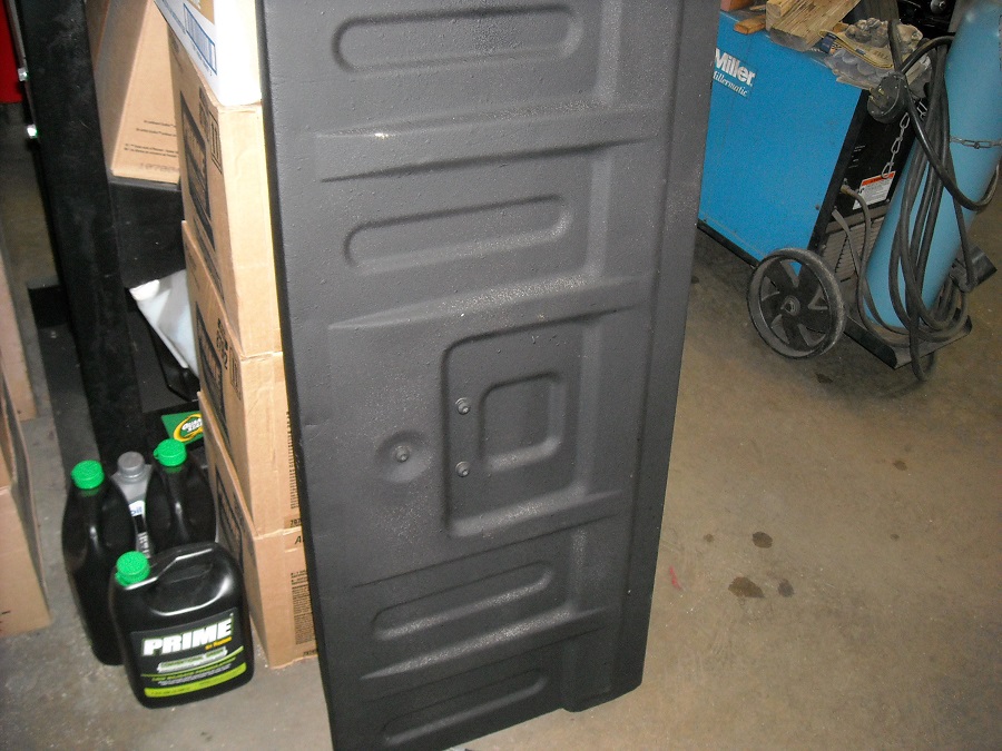

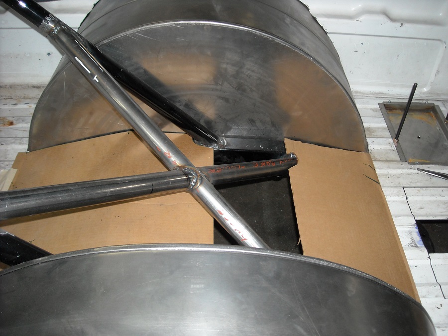

First photo shows final fitting to complete the bed floor.
Second photo shows a test of 3m spray undercoater on the tailgate. I like the look and will spray all the bed interior with that product. It will be a very lite coat just to give the bed interior a clean appearance.
In addition, we will install a white aluminum bed cover. The rear section will have a piano hinged section for fuel and battery service.

Hand,
It is not bed liner material. It is 3M rubberized undercoater in spray can. It goes on in a very lite coat [especially if you move quickly]
Three can will do the job for about $9.00 per can. #08883
