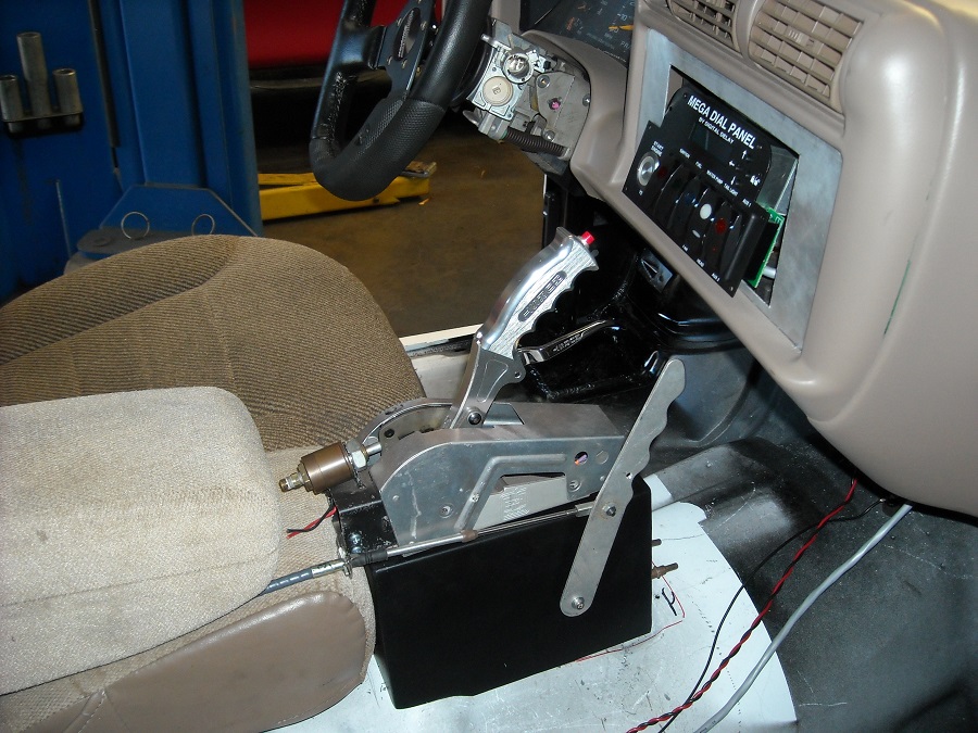

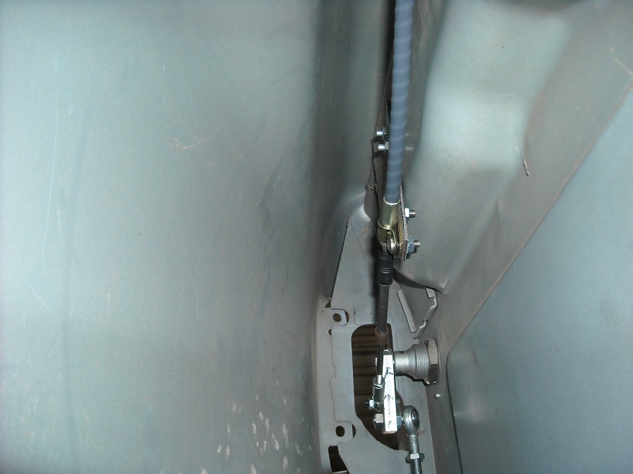

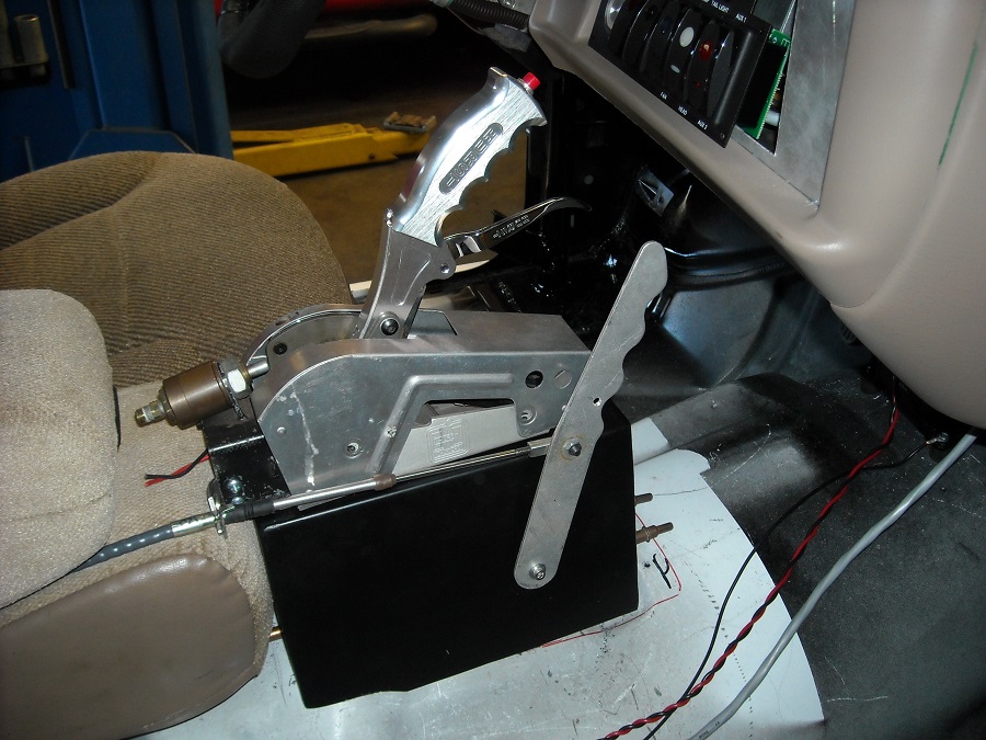

Here are both ends of the master cutoff cable. The "taillight" end has a flat strap tab with clamp and the "shifter" end has a clip like used with a dragster throttle cable.

The drivers handle moves about 1/2 the distance the shifter moves. In the above photos the drivers handle is "off"

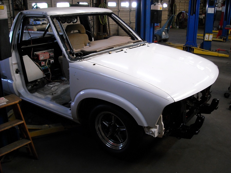

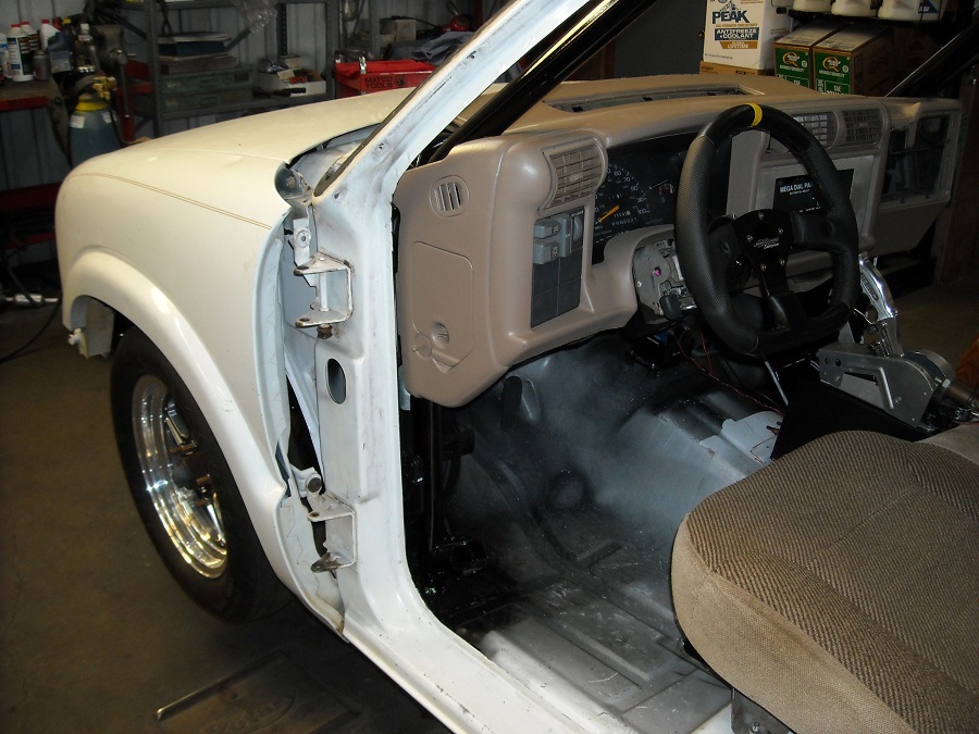

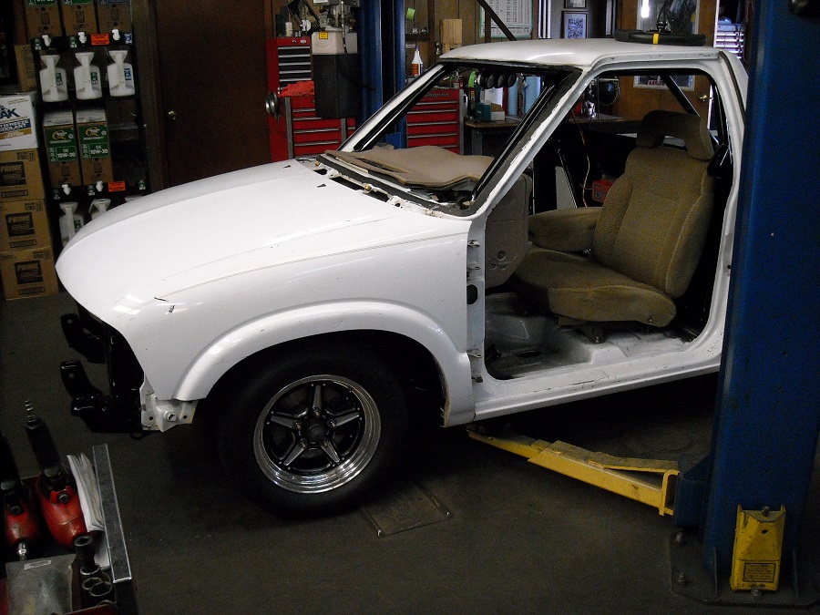

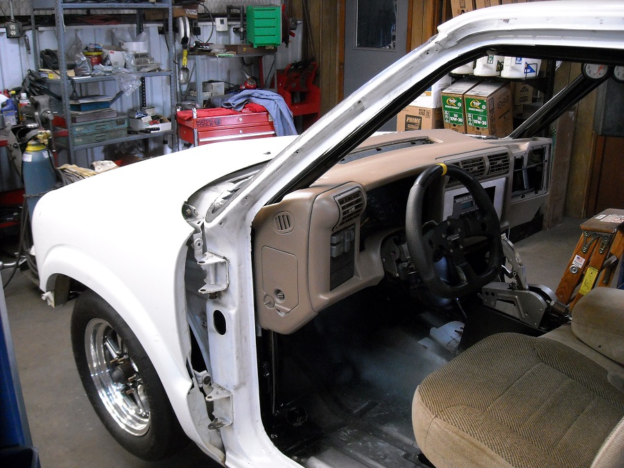

The vision is coming along. Fenders & hood temporary set on for fit check. I wanted to double check where some wiring and some components will be mounted.

Larry Woodfin 471W

note that the switch handle is well ahead of the shifter. This buildup is the 4th time I have incorporated the drivers electrical cut off handle in a race car.
After many runs never any remote situation where the switch was accidentally turn off. During a run you are no where near the lever.
However, there have been several times I was strapped in, ready to roll and the power was off. Turning on power is as easy as reaching beyond the shifter and pulling a lever. Very convenient.
