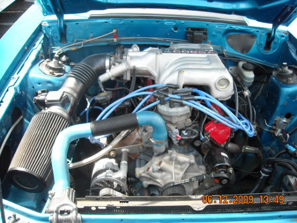

You can get rid of the air box and hose and use a K&N cone filter.
But will it draw more heated air that way?
