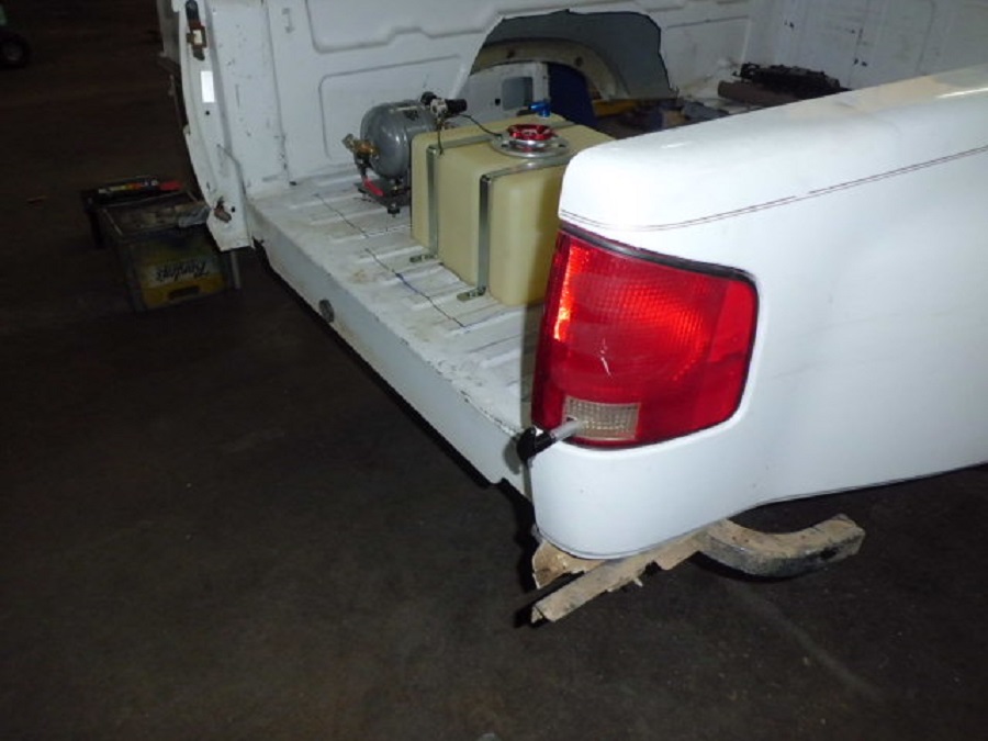

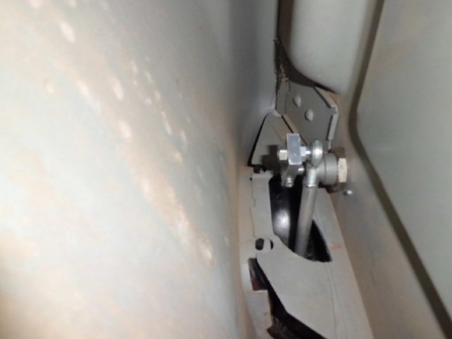

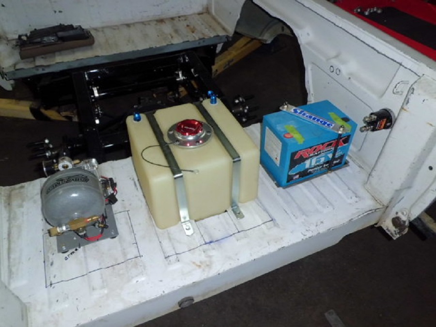

Saturday work time allowed working on a few small items. The small items are important and over the weeks add up to good progress.
I like small, simple details. They give me a smile and are part of my hot rodding enjoyment.
Note:
*master cut off mounted through bed wall
*switch body is inside the bed, control arm in taillight housing area
*"push off" handle through the taillight lens
*battery and fuel cell mounted

Good idea and execution on the master cutoff, and the cable to the cab. Cant count the number of times over the years I have got in the car, got back out of the car to turn switch on, got back in the car cussing... LOL.
