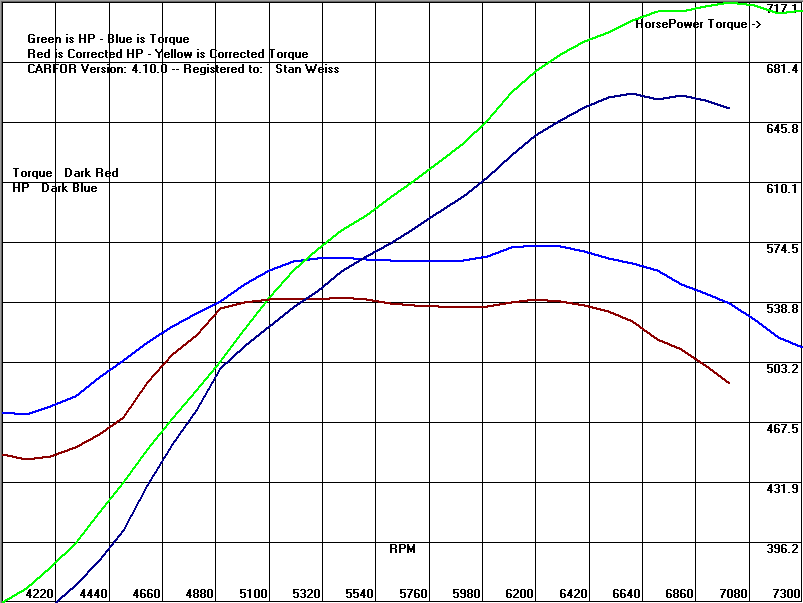

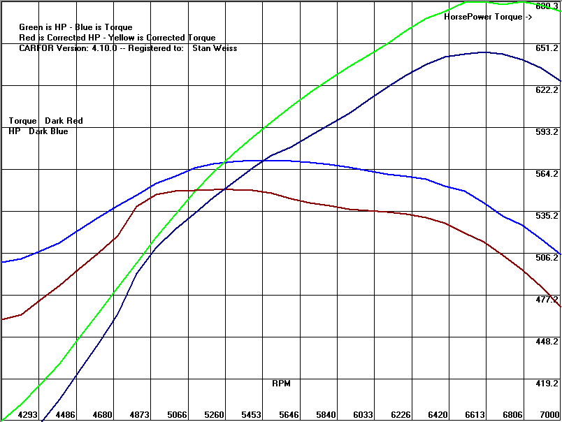

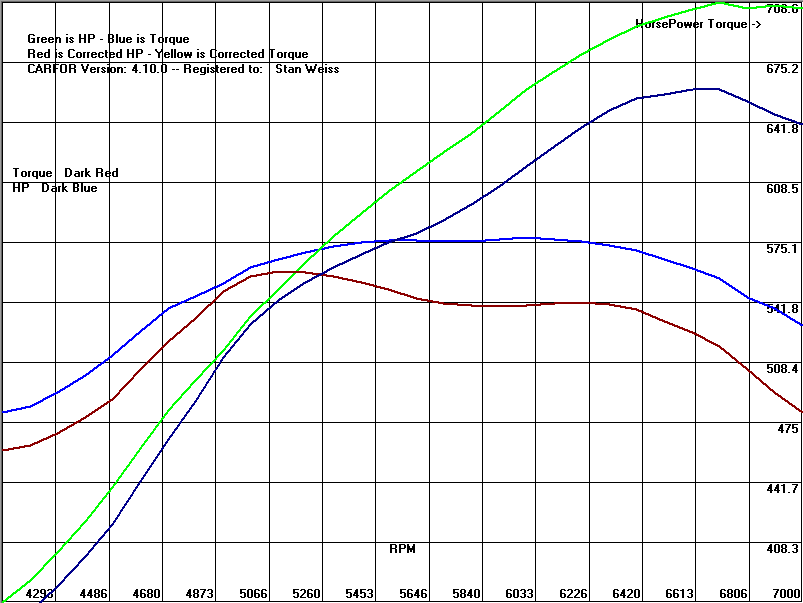

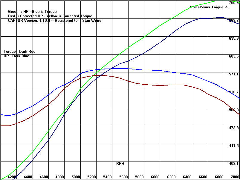

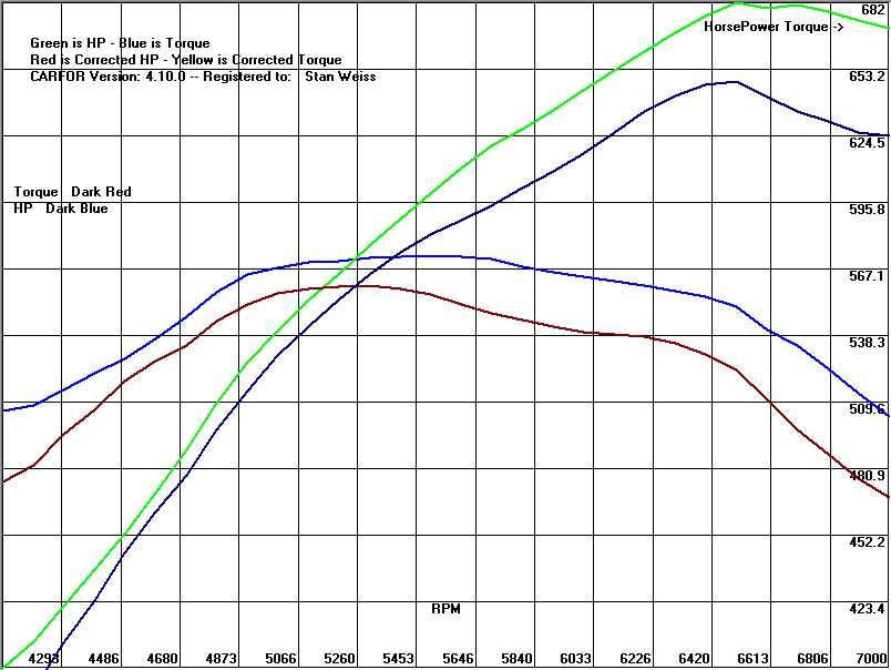

Originally Posted by Stan Weiss View Post
How did each of the cams that were tested with the different heads, intake manifold, headers, and increased CR do?
Stan
As a followup. I find it interesting how at around 4900 RPM almost all of these have the torques come so close together.
Stan
