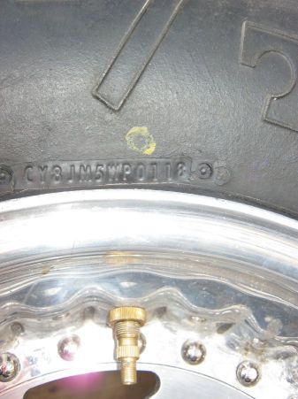

I have a good picture of "the mark" on my new slick:
I can not post the pic for some reason.
If some one would PM me their email addy I would send them
the picture and maybe they could post it.
I would like some one to see the "mark" just to show
that I'm not going crazy!!!

The "mark" you mention? My slicks don't have one like that, but I try and line up the valve stem with the date code box...which may be the same idea. Bubble balance only, no tubes or screws used on Radial Slicks!
