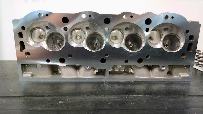

Pictures of the vent holes behind the intake face. This video will explain the run out. AFR was working on fixing these issues.

Just trying to help you, you will find its a simple fix, you just have to do it. Some people might ask how a S/S 295 HP 350 runs mid 9s @ 3100 pounds..........well its the details.
