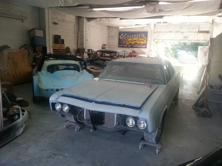

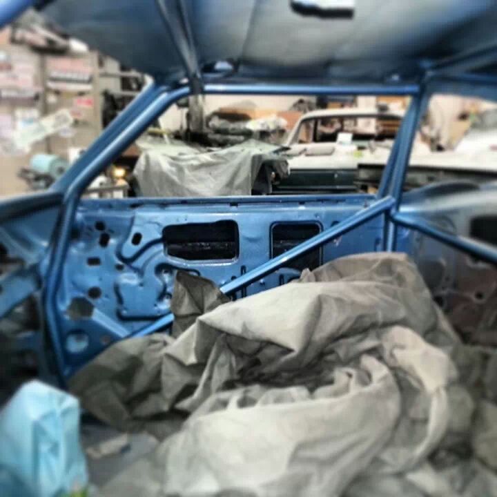

Cage and body is going to be Marina blue.

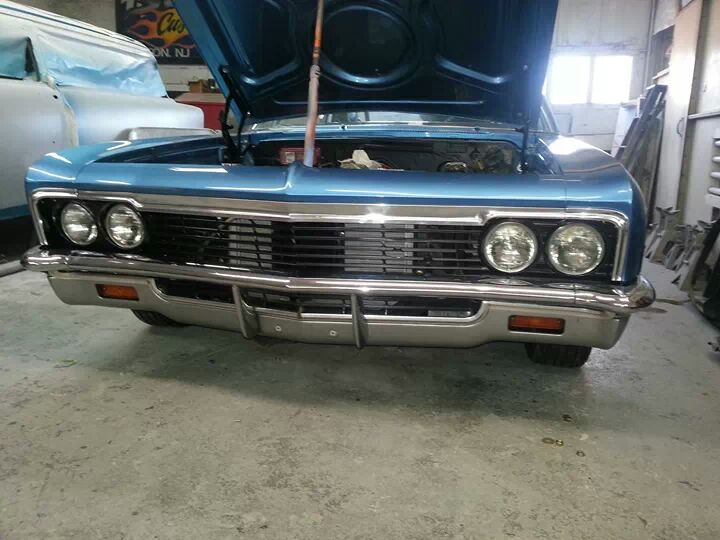

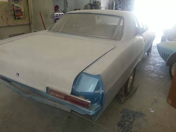

Just need to do the interior with stock bench seat and material.

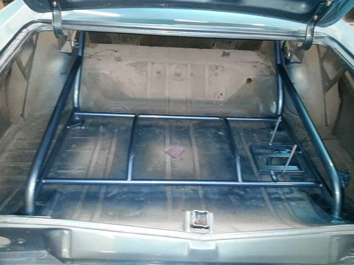

Great looking big ole' Chevy! My 68 Impala (the Green one in the picture ) was an original 427-425 4 speed car, it was sold it to a fella who restored it back to stock because I had the original # matching motor/trans with it.
Just maybe a heads up if you are going to run it, the weak point on these big Chevies (65-70) seem to be the rear crossmember where the upper control arms bolt to. Know a few guys who found our after, they ran slicks and high HP too. I plated and strengthen mine in the 65 Imp stocker I am building. I have a thread too with pics.
Good luck, thanks for the pics.
Will Lamprecht
65 Imp stocker in progress
Old 12-24-2013, 12:12 AM   #14
PROSTREETBISCAYNE
PROSTREETBISCAYNE's Avatar
Join Date: Oct 2008
Posts: 35
Default Re: 1966 Biscayne Build
I plated the rear, basically the same setup you have. Also added a tubular crossmember behind the stock crossmember holding it all in place. My father said he ripped his out too.

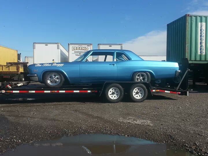

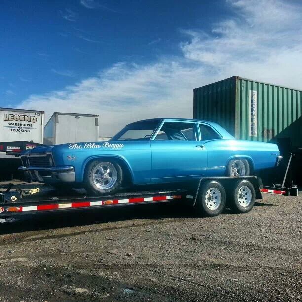

After a long winter I started playing with the Biscayne again.
PROSTREETBISCAYNE is offline   Reply With Quote
