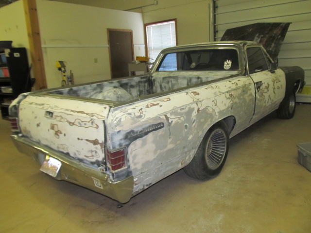

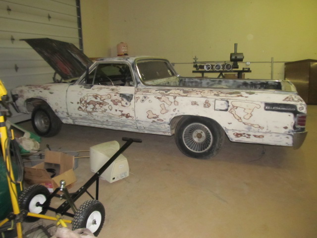

Photographic evidence - work is finally being done.

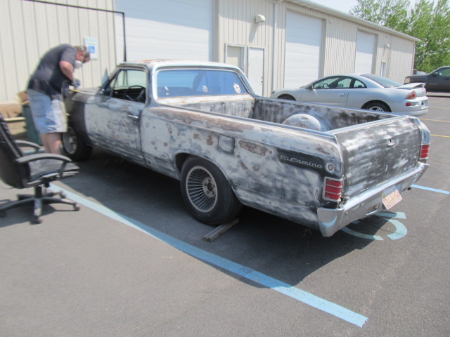

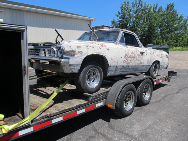

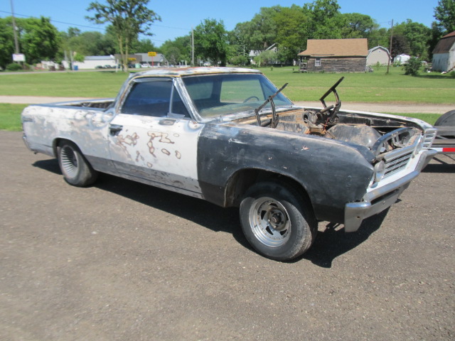

Off to the Blaster! We loaded the El Camino on the trailer today, then I took it to Multi-Blast in Montrose to have the roof and the other bad spots media blasted and primed.

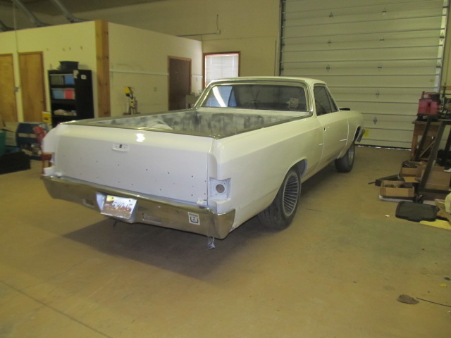

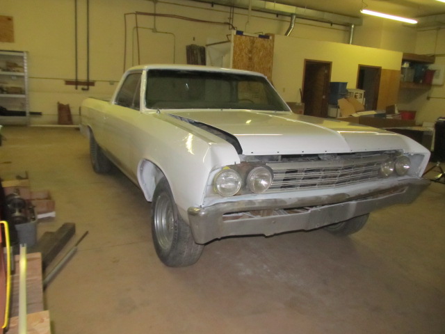

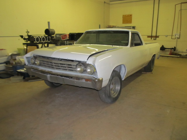

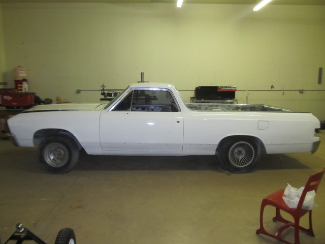

It's WHITE! As in snow blindness white.

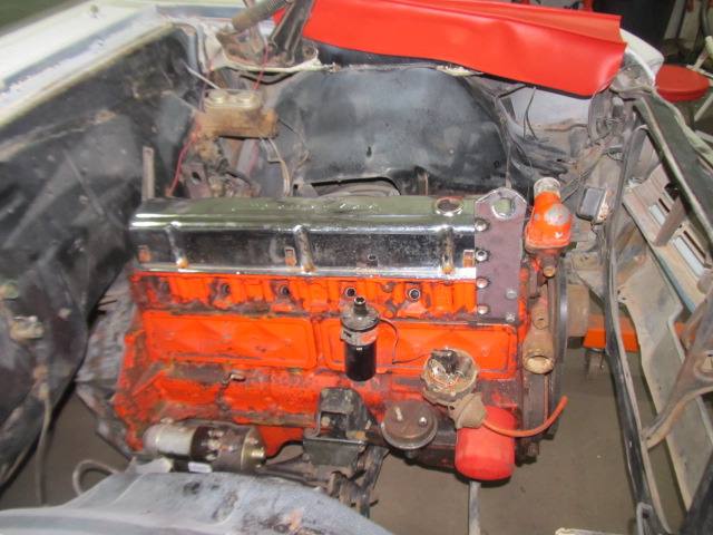

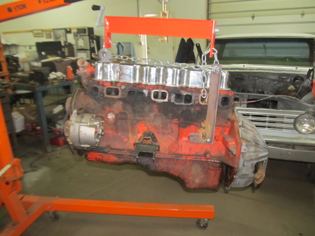

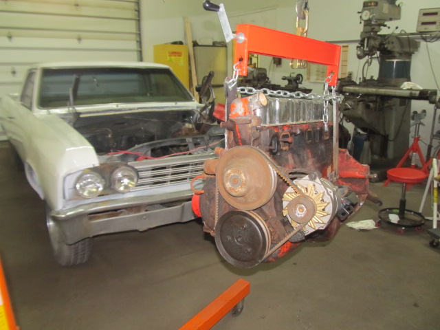

I decided I was going to work on the El Camino this weekend. I have had a 68 230 out of a Nova and thought I would put it in so I can get to the track before it closes for the winter. I put on a Hays 30 lb. flywheel, a new Ram clutch and a stock bellhousing. Billy Nees has loaned me a Doug Nash 4 speed, but I decided to put the motor in without the trans for now. My next door neighbor has a lift and a transmission jack so we will put the trans in from underneath.

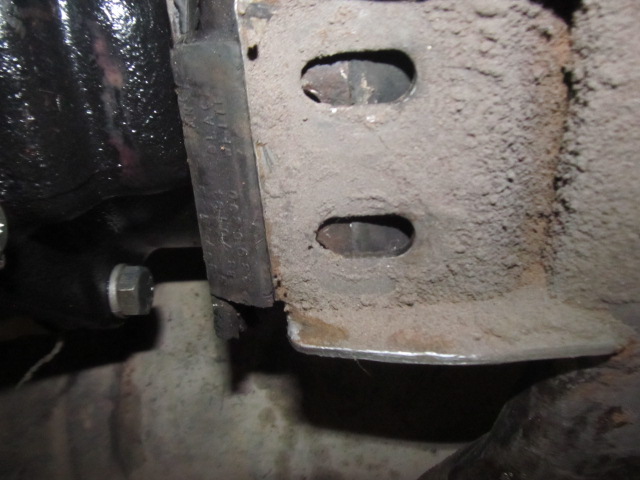

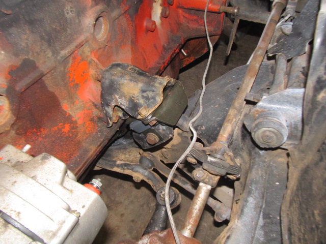

It was a frustrating weekend for me - I got the trans in to find the bolt holes in the mount miss the slots in the crossmember. Then when I tried the headers they hit the motor mount. I have 4 different sets of headers, and they ALL hit! I'm going to make my own mounts to move everything back about 5/8" and that will clear the headers.
