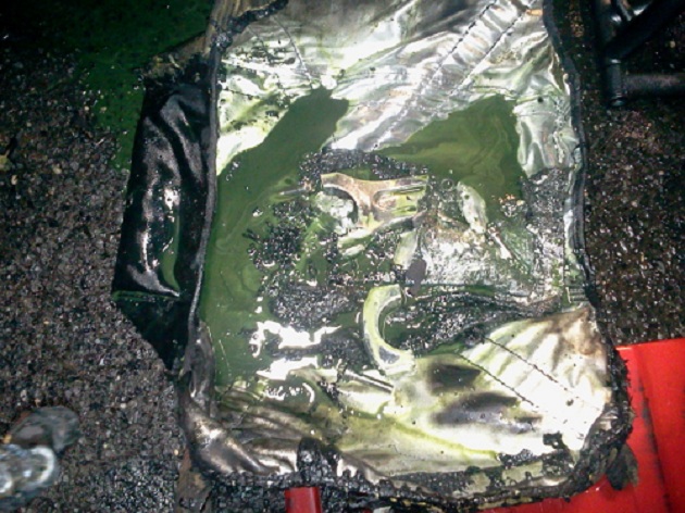

Grant it, a pan/tray may be easier to work with, however I have a tuff time beliving that the tray can contain the fluids without being sucked out of the tray by wind drafts. In the case of a diaper, it's required that it made high enought to meet the block/head mating surfaces. And a tray I belive are only a few inches high........will they even reach the bottom of the pan. ?
Another note, several years ago, WJ was testing pan/trays. His position was " it dosen't work"
Look at the attached pic, and think about it !
Please Be Safe...........
Rick Bailey
(pic stolen from yb)

with a stock front end i think a pan would be even more difficult than a diaper. if you went frame rail to rail the suspension is in the way plus you would have to mount it low to get the 2 in minimum lip . as much as i like my car im thinking about building a s st chassis car for lots of reasons this being one of them
