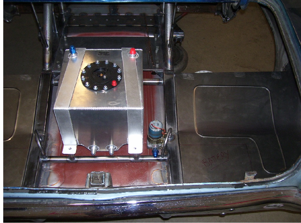

paul reading back over your build post wondered if you have had any tech man question the fuel tank mounted with tabs only no straps. like the way it is mounted along with the seats. thanks jim

An aluminum fuel cell with welded on mounts probably doesn't need straps.

Here is a shot of my cell mounting with straps. I have to remember how to make it bigger because I am computer challenged. If you click on the pic it will get bigger. Also over 70,000 views on this nice build Paul. Tom
Jim -
No questions from tech...it's been looked at by Bob Blackwell, Wayne Lewis, and several others. Thanks for the compliment...I'm a simple guy, so I built it simple!
