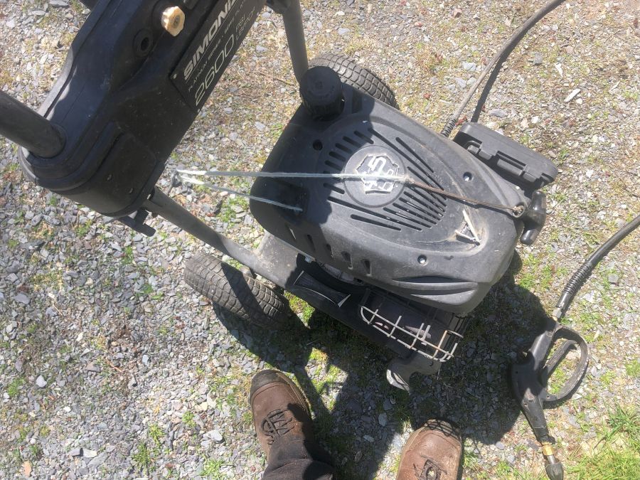

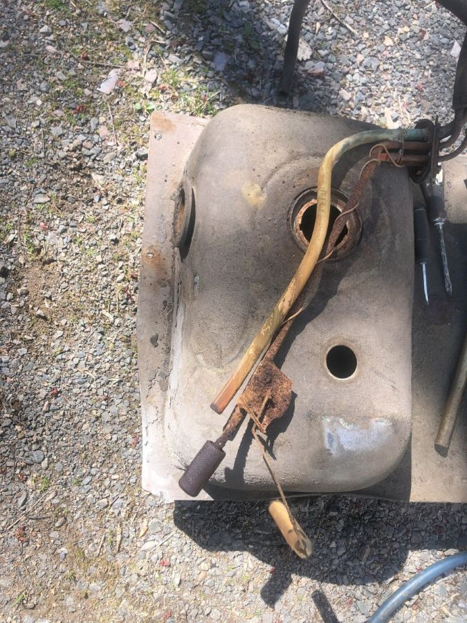

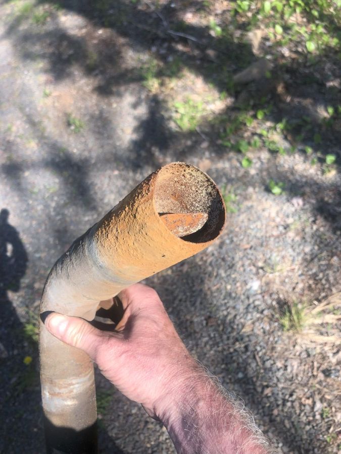

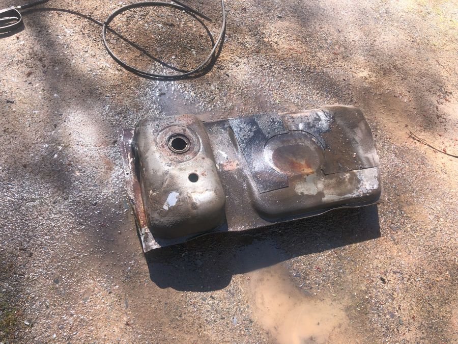

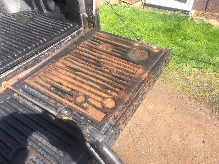

-Went to Armstrong's and picked up my driveshaft and installed it.
-Drained the fuel and pulled the tank, tried to pressure wash it. Of course the cord broke second pull...got a roll of starter rope and fixed it. Once pressure washed, set it in the sun until dry then reinstalled it. Dumped the old somewhat dirty fuel in my truck, it'll burn it, LOL!
-Pulled the carb and cleaned it and reinstalled it.
As you can see on the tailgate and ground, it was full of crap!
Tomorrow I'll get fresh gas and see if I can fire it up for the first time in 6 months or so.
