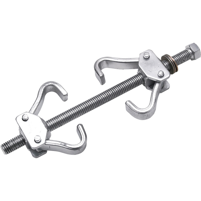

I have used a spring compressor designed like this to remove/reinstall uncut Moroso drag springs on my fox several times. Access to the tool through the hole in the center of the spring perch on the a-arm, and make sure you get as many coils as possible included in the compression.
Btw, keep up the good work, you will have lots of fun with your Mustang!

I have one of these, made a flat plate on the hex end, and went up thru the bottom of the control arm,hooking the upper hooks on the spring.
Yep, that's mine. I removed two of the hooks to make it fit in the spring and reconnected them inside it to finish the job. Lots of painful short radius wrench work.

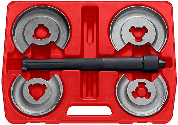

Thanks guys - Our spring compressor consists of flat plates and has been used on all springs installed in Chevrolets...I suspect it will work just as well on the Ford. I have never installed an uncut Moroso spring in any car myself. Hope these springs work out the first go round.
