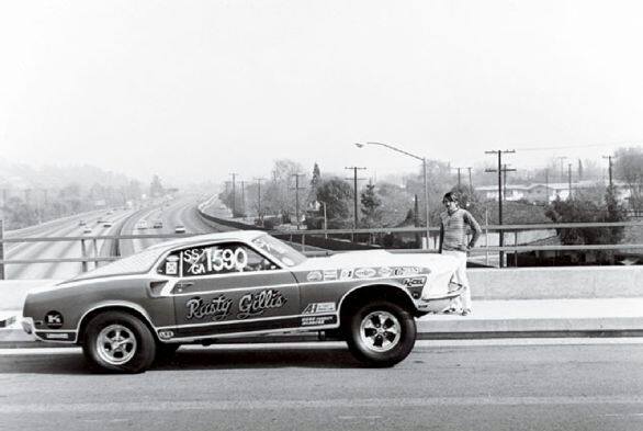

Default Re: 1967 Fairlane Super Stock
Cool pic of Rusty to wake up this thread.
tommy d is online now   Reply With Quote
Old 08-18-2015, 02:43 PM   #120
Rusty Gillis
Rusty Gillis's Avatar
Posts: 260
Likes: 21
Liked 87 Times in 19 Posts
Thanks Tommy.
This was after the Winternationals in 1972 where I won SS/GA class and broke out on the brakes first round of eliminations. I stayed out there 5 weeks and raced at Bakersfield and Las Vegas and made one run at Orange County with an 11.18 ET on a 11.43 record. Alex Walordy was doing a story that come out in Rodder and Super Stock magazine Sept. 1972. In that photo I was on top of I-10 trying to get the wheels off the ground for the magazine story. That photo did appear in the magazine and again in Mustangs & Fords magazine in December 2007.
