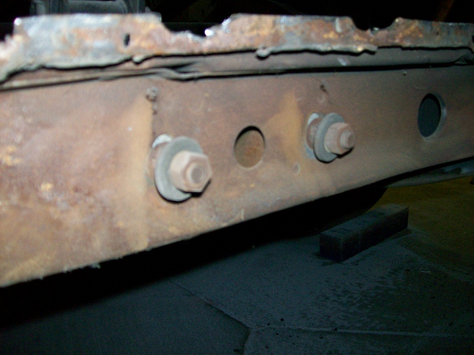

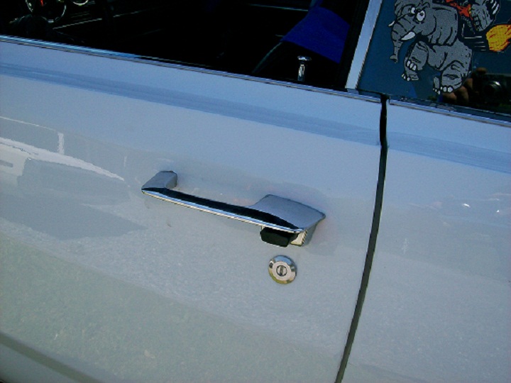

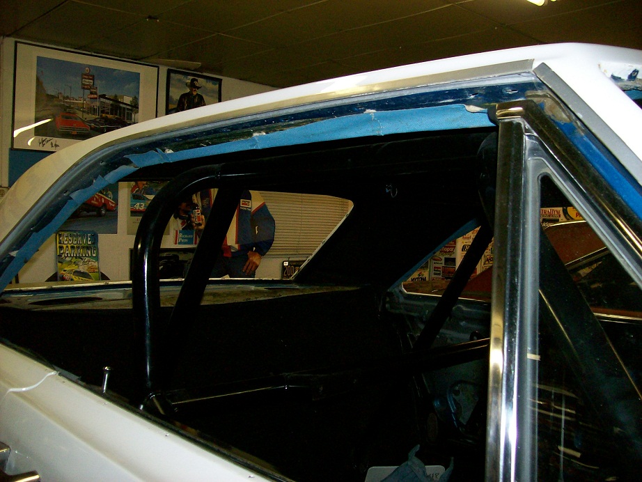

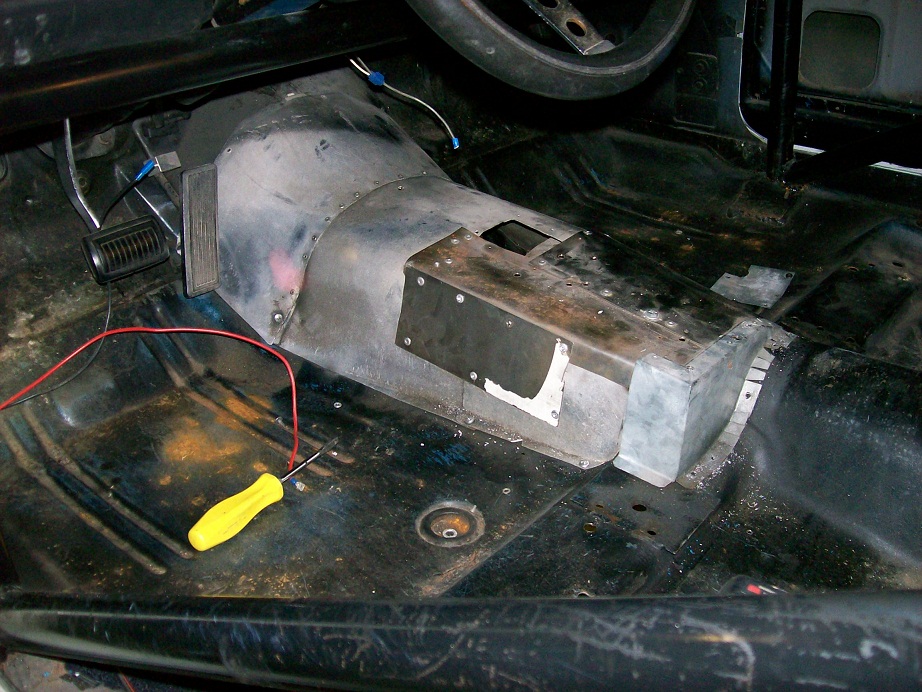

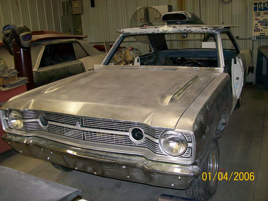

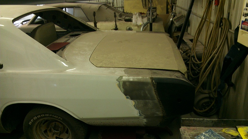

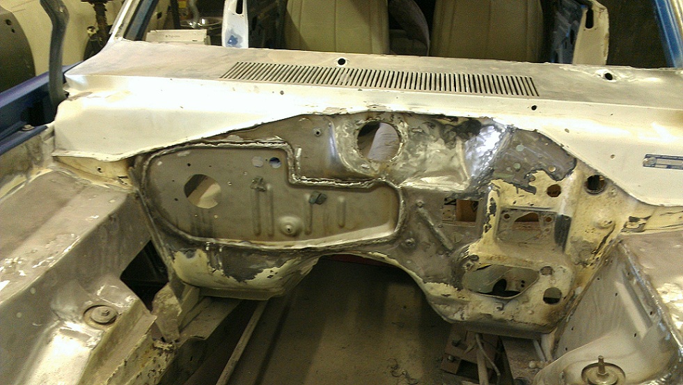

pictures 1. you can see the 68 style door handle (black button) also the door lock is at the very back, on the newer darts its more towards the middle of the door 2. you can see the how it still had the nuts to hold the rear bumper brackets on. 3. the blue paint under weather stripping 4. cut up trans tunnel how they had it. you can also see it has a stick shift brake pedal in it. 5. picture of how i got it. 6. todays picture of how we are welding the panels back in the engine compartment, on the passenger side you can see its still cut out for fender well headers but we already welded the panel in the drivers side to put under chassis headers on 7. you can see how we welded on the 68 rear clip, basically its right on the line how they welded the 72 clip on. 8. the pro stock rear leaf spring mounts

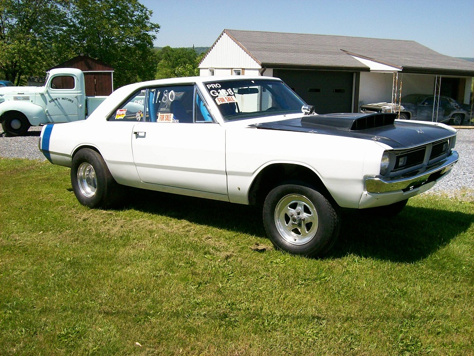

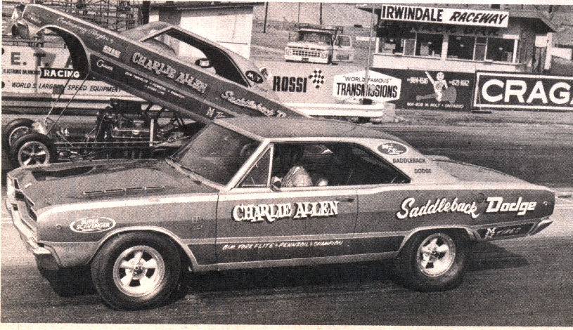

first 2 are originals from 69 i think. the 3rd is a picture of mocking up the front end. now the fenders are in primer.the date is wrong in the picture and the 4th picture is from when chrysler power magazine (roland osborn) owned the car. notice it still has the same paint scheme as charlie had on it orginaly minus the lettering

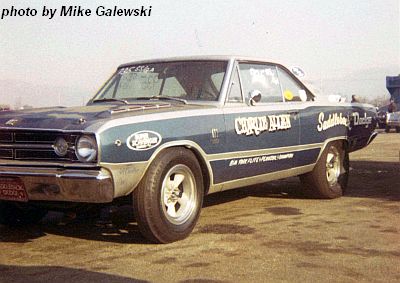

The below photo is a Mickey/Thompson 'knock off'.

Charlie Allen was sponsored by Crenshaw Dodge (in early 1968), and then Saddleback Dodge.
He was at the 5th Annual Hot Rod Magazine Championships {March 22, 23 and 24 - 1968} at Riverside International Raceway (photo below).
Also at the AHRA Super Stock Nationals {August 2, 3 and 4 - 1968} at Freemont Dragstrip.
Also at the Funny Car meet at Lions Dragstrip {November 4, 1968}
January 1969; Funny Car and Super Stock Meet (Irwindale Raceway), which he won with the Funny Car (Low ET = 7.56}
Was there, both with the Funny Car and the 1968 GTS Super Stock car.
March 14, 15 and 16 - 1969 -- '6th Annual' Hot Rod Magazine Championships at Riverside International Raceway.
The photo from Irwindale Raceway must be from; June or July 1969 {if it was in the September 1969 American Rodding Magazine.}.
