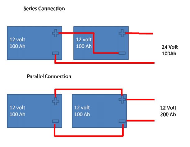

Whenever the topic of dual batteries comes up, series and parallel get mixed up. Series is wired + to - and doubles the voltage. Parallel is wired + to + and doubles the amperage. Parallel makes two 12 volt batteries into one big strong 12 volt battery. Never wire 12 volts in series in a race car.
Dale
Dale
Yep I mixed them up my bad .
I worked on tractors also so I always confuse the two
