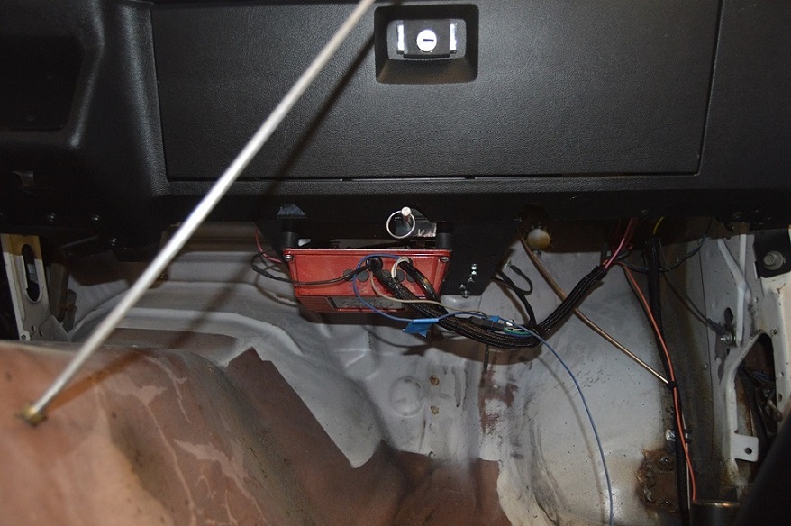

Made some small progress since my last post. I have 80% of the wiring completed. When I bought the car the wiring harness was in a cardboard box, so I made a decision to use the harness as a template and use the wire from the switch panel. I used Painless PowerBraid for bundling the wires, keeps things looking neat and tidy. The problem I have is planning everything out. I would get a bundle of wires run through the firewall and a couple days later find another wire I needed to run with them..plan ahead!
Mounted the 6AL-2 on an aluminum panel under the glove box with a hinge on the firewall so I can drop it down for access. I put the relays on the other side of the panel. There is a slot at the front and a tab that I put a pin in for easy removal. Turned out pretty good.
