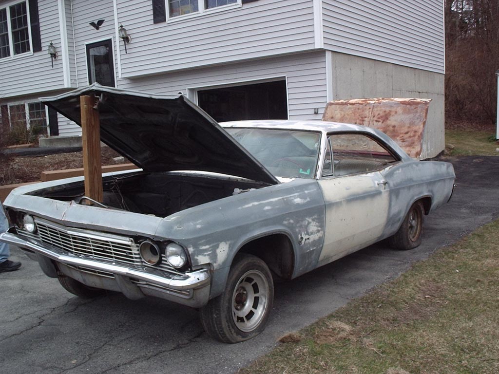

Hey Joe, good hearing from you. Yes, Carl is taking pictures and video. I will be posting a new pic next week of the rear frame gusseting work. Only way to make these boats survive!
Rob has the motor in South Carolina with the 1976 Ford F100 truck i bought down there. He has been using the truck w/ the new house. Don't know if I can use it as a tow vehicle, being a Ford and all!! LOL Dan, the lightest I had the 68 was a the minimum H/S weight or 3950. I added a 135 pound bar to the back to make I/S ! If you want i can e-mail you a pic of the rear work I did on the car so you can show your chassis man. Will Lamprecht "Tuns of Fun" !! 65 Impala |
