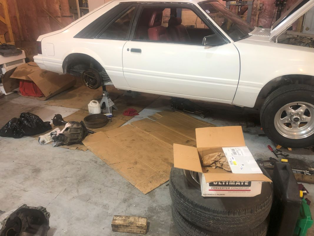

So, where to start...
Got home safe, all is good. Checked the spline in the center section and yes it's different. (I have stock 28 spline) So it's either 31 or 35, whatever, has to come apart. I have a 28 spline coming so no biggie.
Installed the reverse pattern valve body and everything is ready to go...(wait for it...)
Fixed the leak in the pan, dropped tranny and tried to pull it back enough to pull the converter. Converter is stuck to the flexplate, an hour later of prying and turning the engine, prying, turning. Of course I'm by myself so get out from underneath, go to the front and turn the engine 1/4 turn, get back underneath, pry, get out, LOL.
Got the converter off the flexplate, slid it out beside the new one...uh oh...bolt pattern different...I have a truck c/4 (pan fill) and the 11 1/2" flex plate, not the 10 1/2" car flex plate in a case fill c4.
Crap.
I have a c4 out back, I'll go to grab it....then I see the tarp is ripped, the dipstick tube is missing and it's full of water....sigh...
So...
Pull the car tranny apart and see if it's serviceable or trash.
Pull the reverse pattern valve body back out of the truck tranny and put it in the car one, IF, the car one is good.
Dig through my parts and see if I have a flex plate, right diameter and right weight.
Replace the front pump bushing with the one supplied by ATI.
Oh, you know there's more to come and I've got 2 weeks to the Open in Miramichi.....

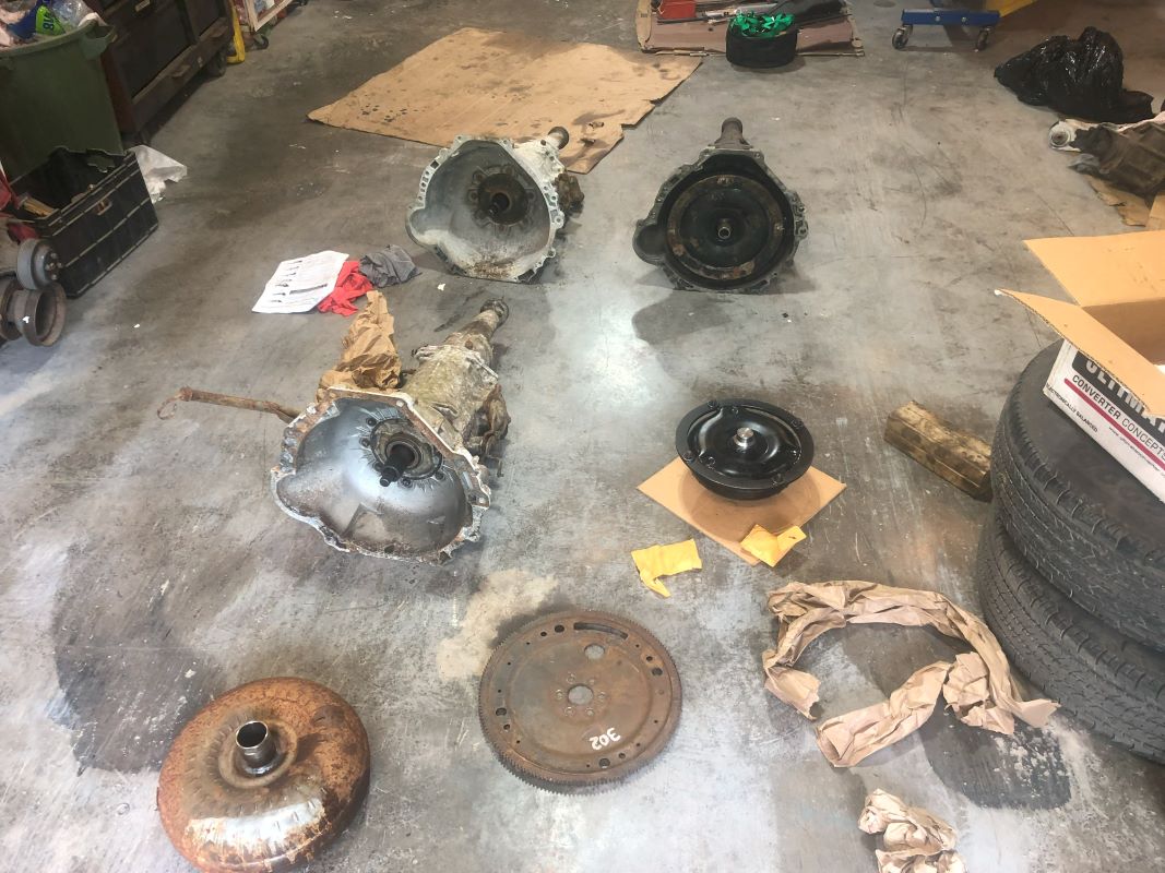

Got the tranny from out back, it's a case fill...with a 164 tooth bellhousing! Same as the pan fill is a 164 tooth flex plate.
I need a 157 tooth flex plate and bell housing which as far as I know only comes with case fill car transmissions.
Went up the road to a ford buddy and he has a c4 out of a 73 mustang/302 that he personally can verify it's original...it's a pan fill truck transmission with a small 157 tooth flex plate and smaller bellhousing!!
Holy CRAP!!! Nothing Ford does is the same from one minute to the next!
So I bought the transmission from him, now I have to go through it and install the reverse valve body, all I need now is the 157t flex plate. The one that came on the 302 we pulled this tranny from?? The bolts are rusted and rounded off holding the converter to the flex plate. So if I can't find another one from another local ford guy, I'll have to fight with that. The other option is order a new sfi spec flex plate..which I might do as well.
Nothing money won;t fix huh?
And then there were three.....

Just remember, as a rule, a one piece rear seal is the 50 oz. imbalance, and the 2 piece seal is 28 oz.
Flexplates can be had in either configuration.
