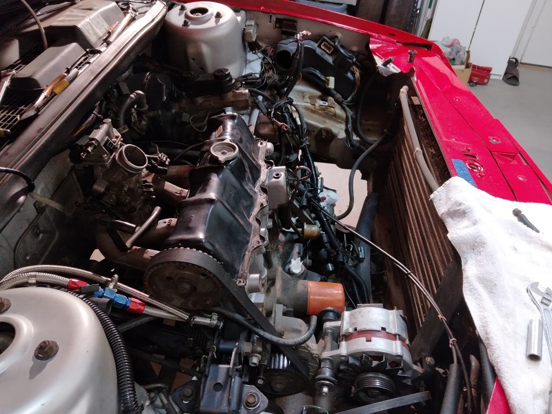

Engine coming out after roughing out the elect. water pump and a few other items like getting rid of that nasty stamped steel ugly valve cover.

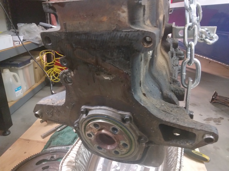

It looked like 93K miles and 25 years of sitting.

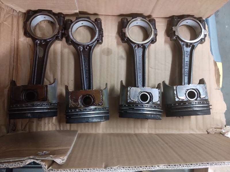

Bearings looked great, pistons not so much.

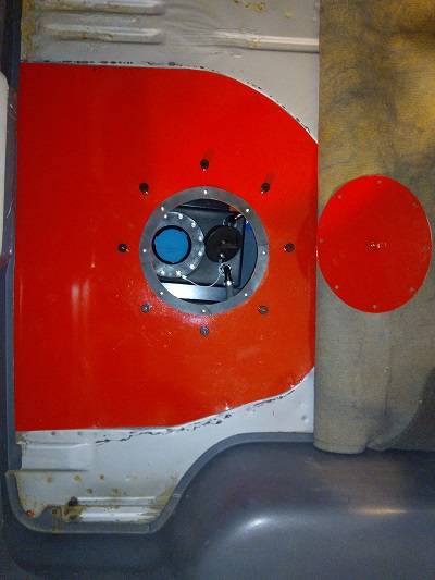

The fuel cell upper bulkhead.
