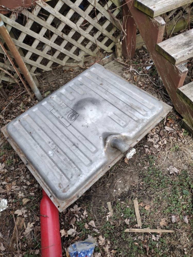

Fuel tank is out
Name:	My project (36).jpg
ID:	65849   Click image for larger version
Name:	My project (38).jpg
Rose Racing is offline   Reply With Quote
