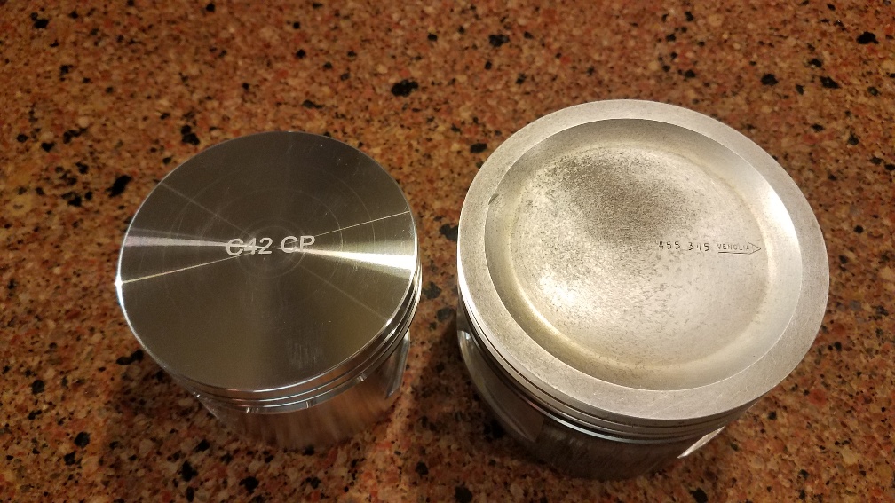

Started to collect parts for next years "new 265" build.Pistons came in the other day.I set one next to what I'm used to dealing with, a 455 Buick slug.LOL Don't have the blue 55 car anymore.Guy that loaned it to me wanted it back. So this winter I will be building my own 55 from the ground up for the P/SA and Q/SA wars next year when I'm not racing my Buick.LOL Will be getting the 55 shell inside and starting to rebuild the front suspension in a few weeks.Will keep you informed, as well on updates on engine build.

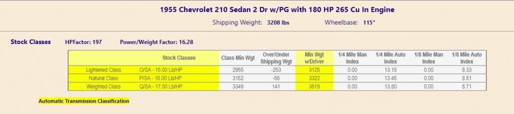

Lyn, the 55 sounds like a lot of fun what does the 2dr sedan have to weigh for Q/SA ?

When NHRA put the older cars back in the guide a few years back they raised the 1955 4bl HP from 180 to 200. It has been lowered some to 197. Needs to go further down, as the 55 265 has to use flat top pistons which means you have to use a cam with 230 degrees duration or less, or you will have valve to piston clearance problems. Mid way thru 1956 GM started building 265s with valve notches. They discontinued the over counter sales of the flat top piston about that time also. In the Jr Stocker days you could use the notched 265 pistons, but not now. Go figure.
